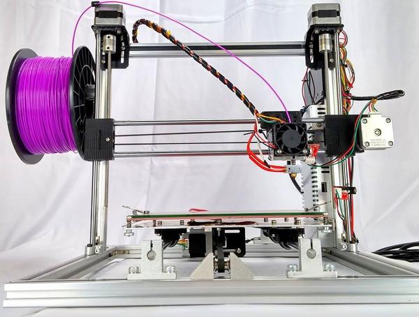

I’ve decided to go after this kit… Just because is full aluminum
What do you guys think.
The motors look painfully inadequate. Other than that, the design looks adaptable. Check for forums and reviews.

Replacement steppers would be about 30% more above the cost of the machine. Make sure the control board they provide is good quality. Other than that, most of the components are aluminum which means it’ll be hard to break. Thats assuming they are machined properly, but you can work around small issues by shimming and adjusting - it’s not fun to do but its free.
Designing and building your first machine is costly. A kit is a good way to go, but since its your first machine you wont know what to look for, what issues you’ll run into.
The most common failures of cheap machines are: hotend, bent rods, faulty electronics, cheap motors, bad engineering, poor quality printed parts. A lot of these you won’t know until you get the machine, others come with experience in knowing the stress points of the frame and materials.
Also make sure the electronics aren’t some custom job. Stick with the standard open source stuff. Then at least, if you have issues, you have other resources.
