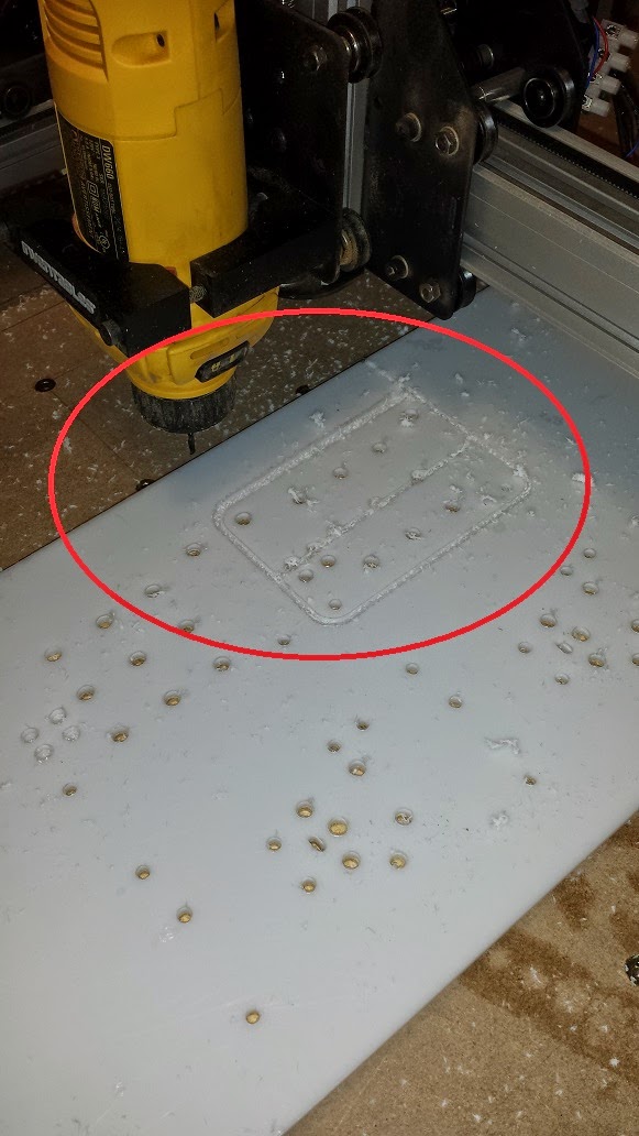

I have been having trouble with chilipeppr, I seem to have a tool just wandering off and shifting a cut by several inches. This happens later on in the cut and the only thing I see that could be a problem is the buffer keeps getting low. 3-4 mostly and going yellow. Could this cause my tool to miss a command? very frustrating Is there a way to increase the rate of data flow to the tinyG? If this isn’t the problem does anyone have an Idea of why my cnc wanders off every now and then?
I know immediately what your problem is (I think) is that you need to keep all your motors powered on during any move. Your controller is probably set to let the motor turn off on an axis that doesn’t have any moves. Well, that config will cause what you’re seeing because as you move along one axis the other axis drifts. You need the motor to hold your timing belts hard into position.
My controller is set to turn off. I will change that. By the way John, this software is awesome. I’d like to thank you personally for making it. I only wish I could get the webGL thing to work on the Rasberry PI.
