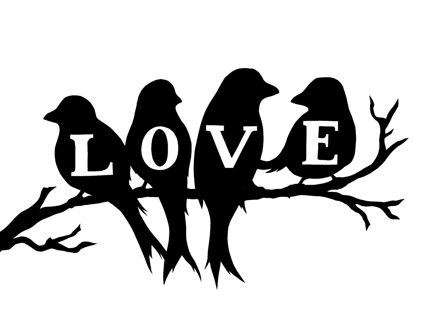

Hello. I have been playing around with my K40 for a little while, learning the “ins and outs” of using it. I think I have a pretty good grasp of the engraving part, but I cannot for the life of me figure out how to make it cut anything. I am still using the stock CorelLaser/CorelDraw that came with the machine. I have no clue how to use InkScape although I do have it installed. I was trying to use the attached image to test out cutting a silhouette of some sort that has an inside cutout, but no matter what I try it never even shows up on the preview when I click the cut button, and if I hit Start anyway it instantly says it’s done. Can somebody please explain (or give a link to) how I can make this work? Thank you in advance.
What type of image is it
Are you wanting to leave the black areas and cut out the white?

Assuming you want the black to be solid and the white to be cut out (the reverse would work too using the same concepts that follow), you’ll want to put a little horizontal or vertical rectangle in the O so when you cut it out it doesn’t drop the black center out too.
Then you need to create a outline around the black portions - you can do that by using Corel’s trace tool. Copy those lines to a different layer.
Send the cutline layer to the laser. You’ll end up with a solid set of birds on a branch with the words cut out inside.
If you want it the other way where the black is the negative space (perhaps so you could use the stencil to spray paint a bunch of birds onto some surface) it will be a little more complicated because you’ll need to create thin bridges from all the interior letters to the outside edges or they’ll fall out of the stencil when it’s cut.
Thank you. That worked great. I didn’t even realize CorelTrace was there, it counts as a different program and I was trying to do everything inside CorelDraw.
