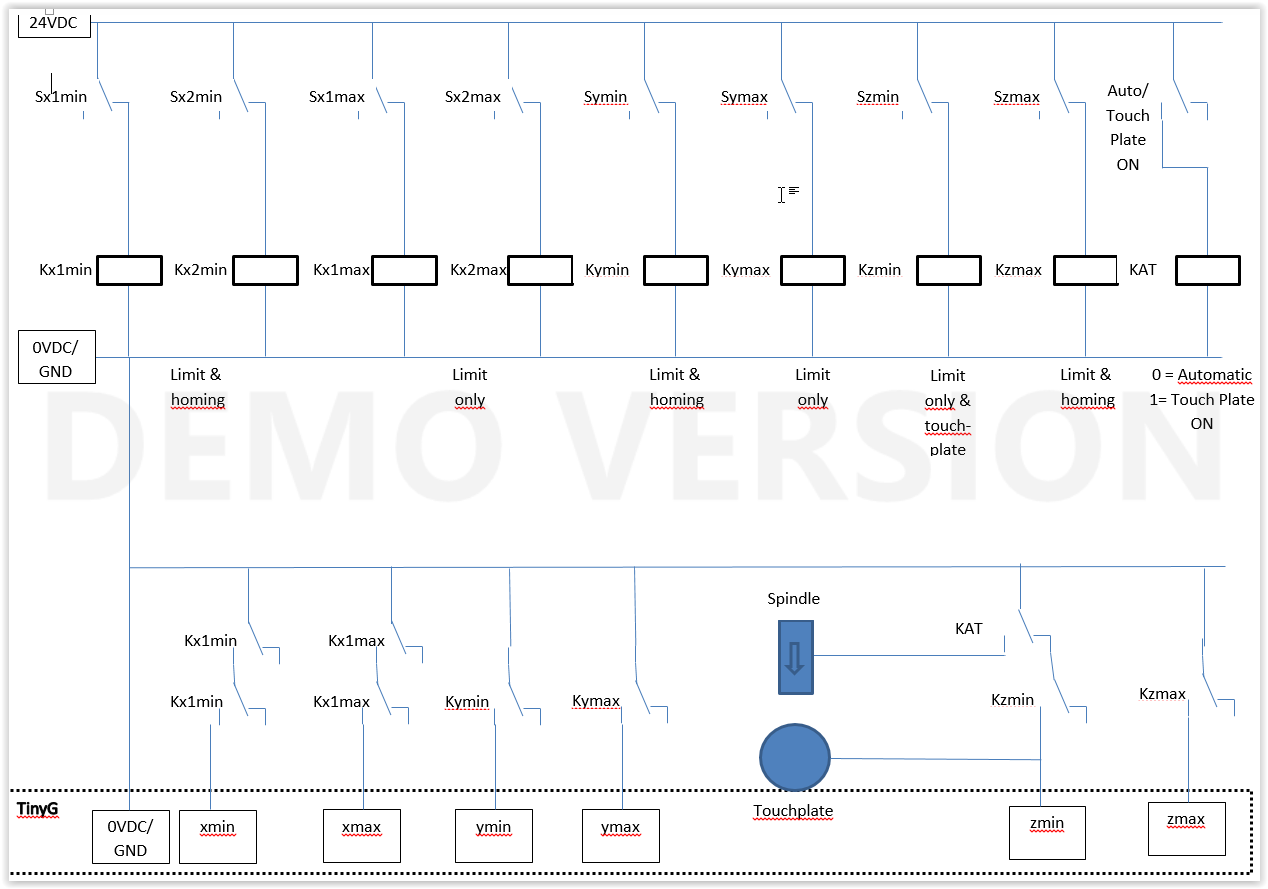

I have few problems and perhaps somebody knows how I can fix or approch to find the error.
Troubles: If using touch plate once touching it just goes a bit up and stops like Limit switch reached. Sometimes Reset from Chilipeper doesn`t work anymore, I suppose the Communication fails. Usually how in 99% of the cases I get it back running is by unchecking Box of Com Port to JSON Server, RESET button on Tinyg, waiting a few seconds, and afterwards Reseting the checkbox for communication.
I read (I think it was John Lauer ) in a troubleshooting Forum that there was other people having that issue. So I disconnected all switches, configured all switches to none, but touch plate issue remains.
Only thing I haven’t done yet is disconnecting the 2 external driver of X.
I wired according to Diagram, and according to this settings. As long as I do not need the touch plate everythings works just fine.
Settings and cabling before i started my Troubleshooting:

I have wired it as on the Picture shown. I use 24VDC relays to prevent any noice from Machine, and keep 3.3 / GND Lines as short as possible.
Thanks for suggestions.
