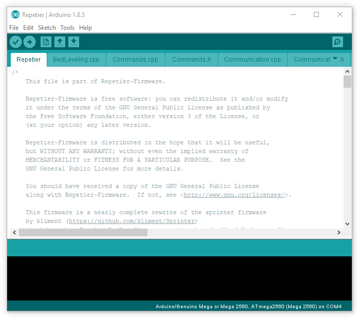

I have uploaded on my arduino mega the repetier firmware and I have try to move the stepper: it’s works without problem.
