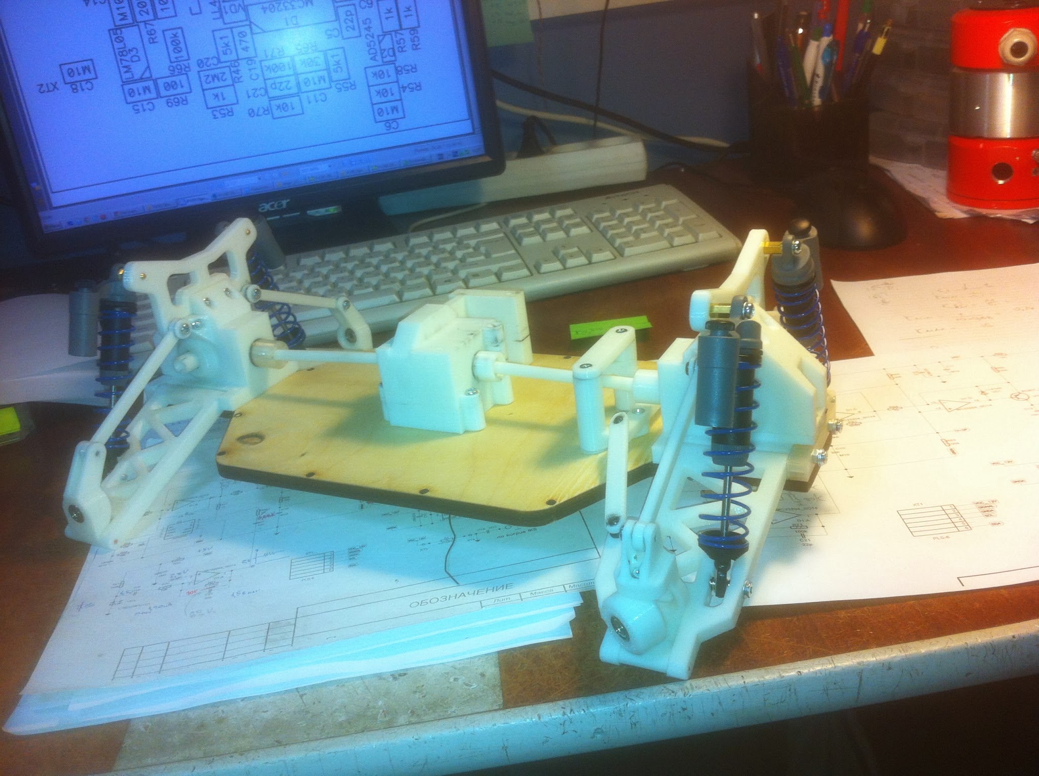

Hello! I have one question: Why shafts are not in line?
my first guess is, that the hohles for the chentral diff are not in the right place. somehow there are different versions of the cnetral diff and the chassis plates, i dont know exactly which fit together.
My second guess there could be some warping involved. you can check this on your printer by printig some calibration model…
The central diff has a slight offset from the middle to make some more room for the battery. It was changed in some of the later revisions.
@Emile_Wim is right, i had to move it off center to make room for the battery. It´s not the best solution but will have to do for now.
Thank you.
And why cardan shaft Is located at an angle?
front differential and wheel bearings are also not on the same line.
