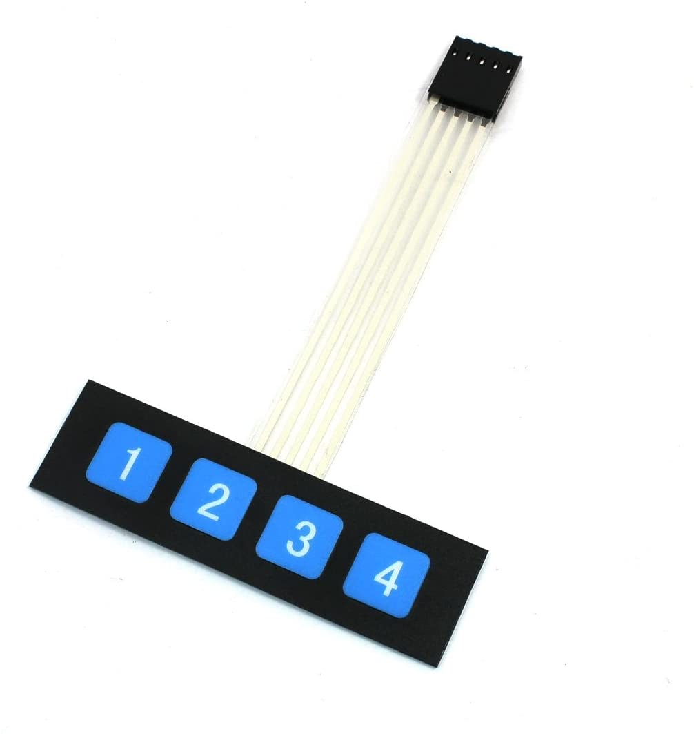

I have a simple 4 button that I will use for this project:
I tried to add code using the Button-Master library (renamed Button) to the Demo Reel. Its very confusing to know where to add the code.
I would simply like to display the first pattern Confetti_GB and if a button 1 is pressed to stay on that pattern. If button 2 is pressed to show Juggle and stay on that pattern. If button 3 is pressed to show Sinelon and if button 4 is pressed, to show rainbow. If button 1 is pushed, show Confetti_GB and wait for more input.
Basically if any button is pushed, to switch to that pattern and stay there. Is this possible?
