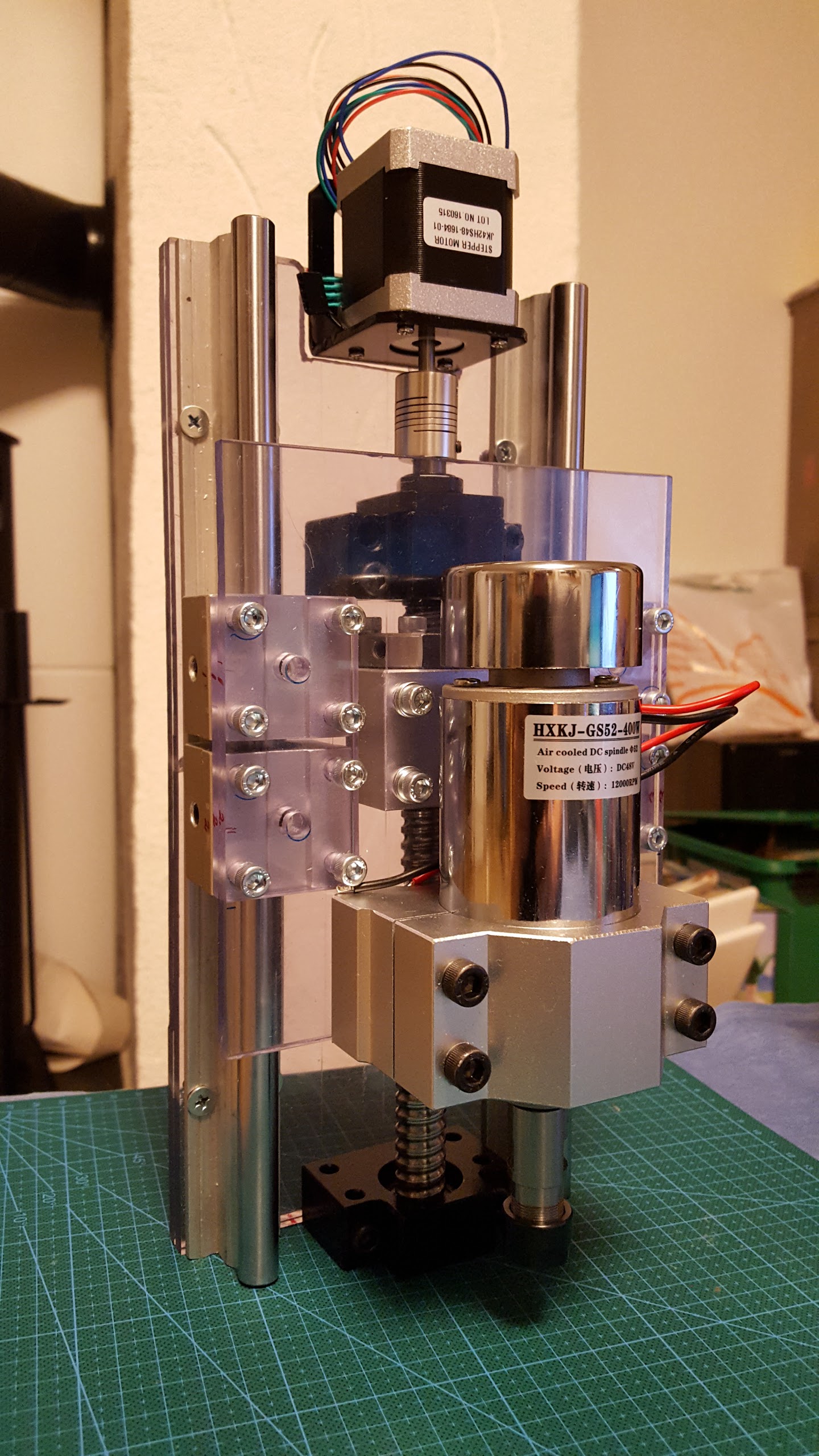

Hello. I have started making My DIY CNC .
Hello. I have started making My DIY CNC . I have started assembling from Z axis just cause I designing it on the go :smiley:

Taking a mind at my tools and work plase :slight_smile: thats what i got it for now :slight_smile:
