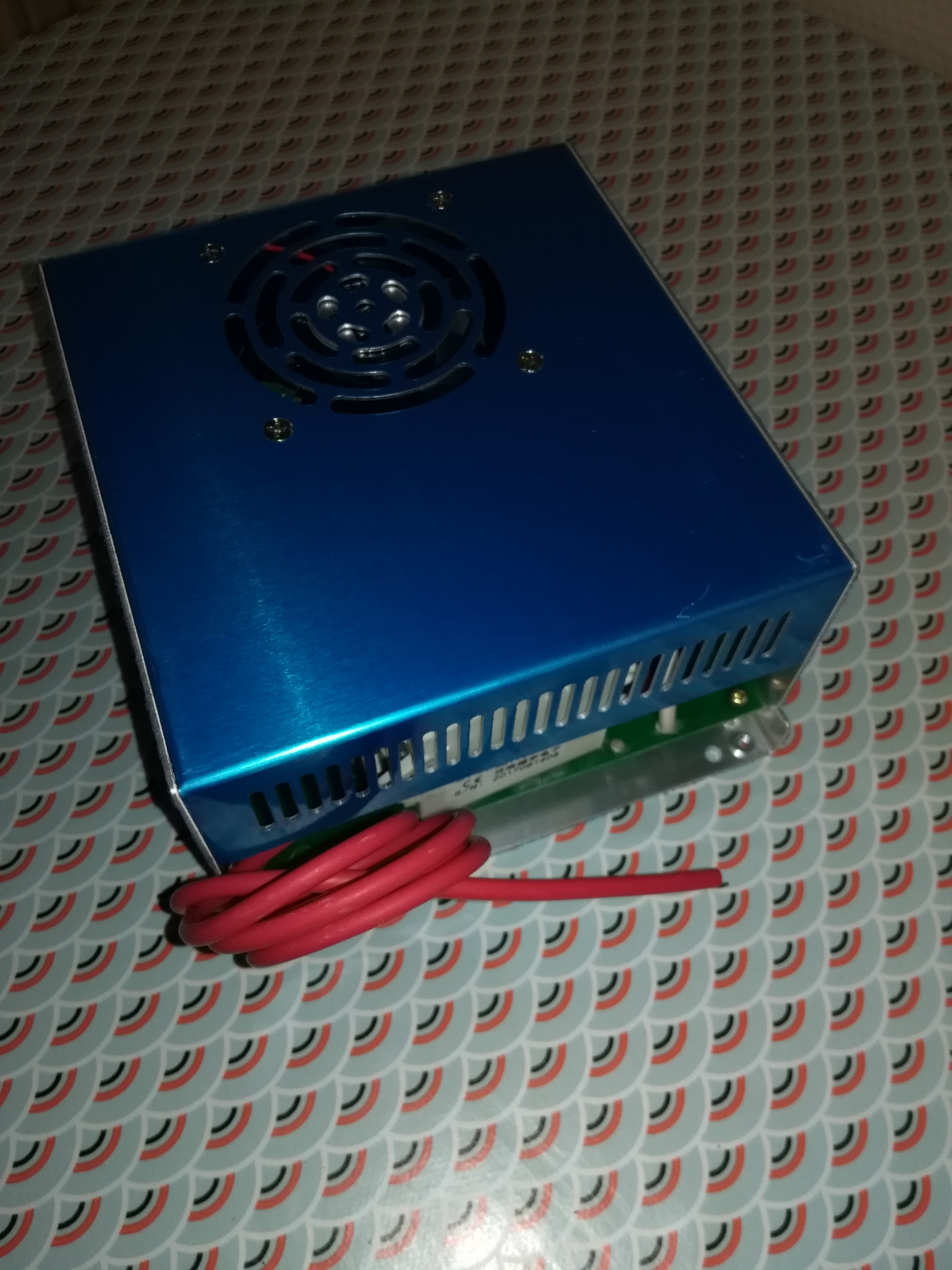

Hi all, Hi @donkjr , have just received my new power supply, Do you have any advice or point of attention for setting up? I would not blow up this one !! :slight_smile:
@Jean-Phi_Clerc there really is nothing to setup in these supplies.
UNPLUG ALL POWER FROM THE WALL.
  1. I would remove the thin blue film on its case. It serves no purpose that I can find and I think it reduces its thermal properties.
  2. Make sure that the FG is connected electrically to the frame and that it is bolted down solid.
  3. I dont recommend soldering the anode connection (because you can damage the tube) but if you do use “ball soldering” technique.
  4. Use the proper silicone when re-poting the anode connection. A post on replacement is attached. The white silicon that came with your machine is the best but alternatives cited in the post are good also.
  5. Route the anode wire as far away from metal and ground as you can. Don’t tie wrap it to anything.
  6. Connect the cathode wire back to the -L of the supply and nowhere else. -L is on the leftmost connection on the supply. Do NOT confuse with L which is on the rightmost connection. Should just be a matter of reconnecting the wire you took off when removed the supply.

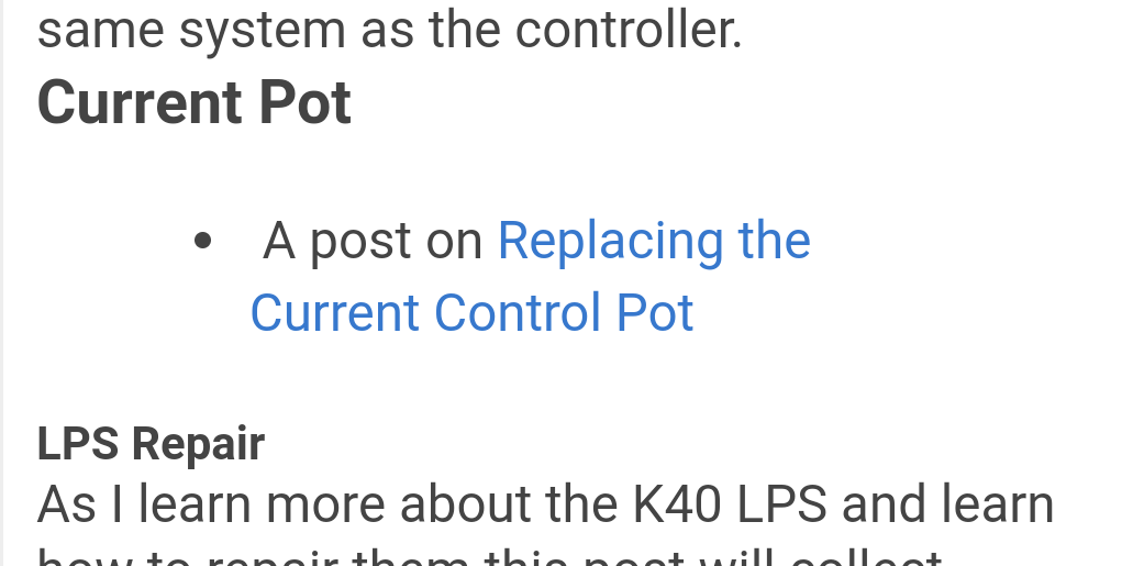

@donkjr ​ I read again your fantastic resource information site about K40, i found a bad URL, in picture attached
@Jean-Phi_Clerc can you provide me a url for the above as I cannot find this snippet :).
BTW you can leave comments at the bottom of blog posts :).
ok, so i give information in the blog directly :slight_smile:
