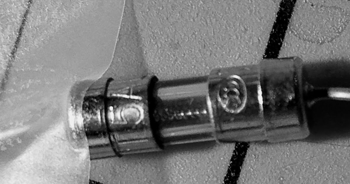

Hi all, i come back, was away since few days, and my problem with the K40 wait after me :wink: i found this fuser : http://www.conrad.fr/ce/fr/product/537935/Mini-fusible-ESKA-887124-temporis-T-sortie-radiale-rond-5-A-250-V-1-pcs?ref=list (french) do you think it is the good one

…FUSE
That fuse should work but I have never used that one.
Below is a post with information on repair including an axial fuse link on amazon, which might be an easier install.
It also has updated schematics.

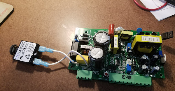

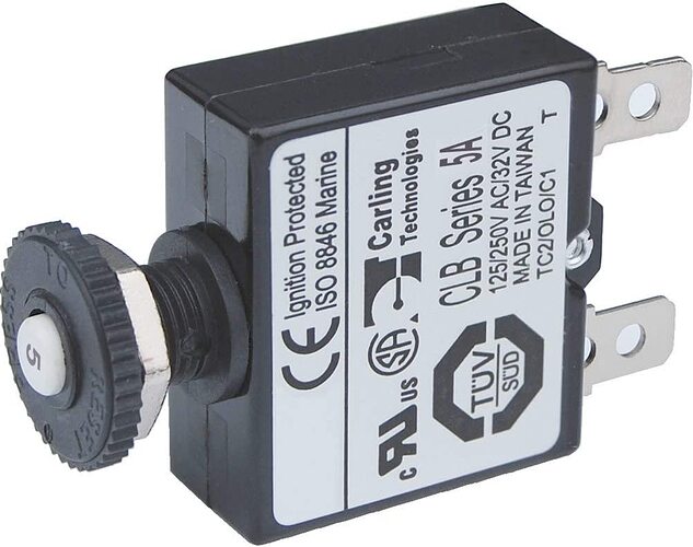

You can also install a 5A car blade fuse and holder which has the advantage of being easier to get and is replaceable without an iron. You can usually get the holder and blade at car parts stored.
I install a reset-able one during a supply repair because I have found that I blow them a lot during troubleshooting and soldering is annoying.

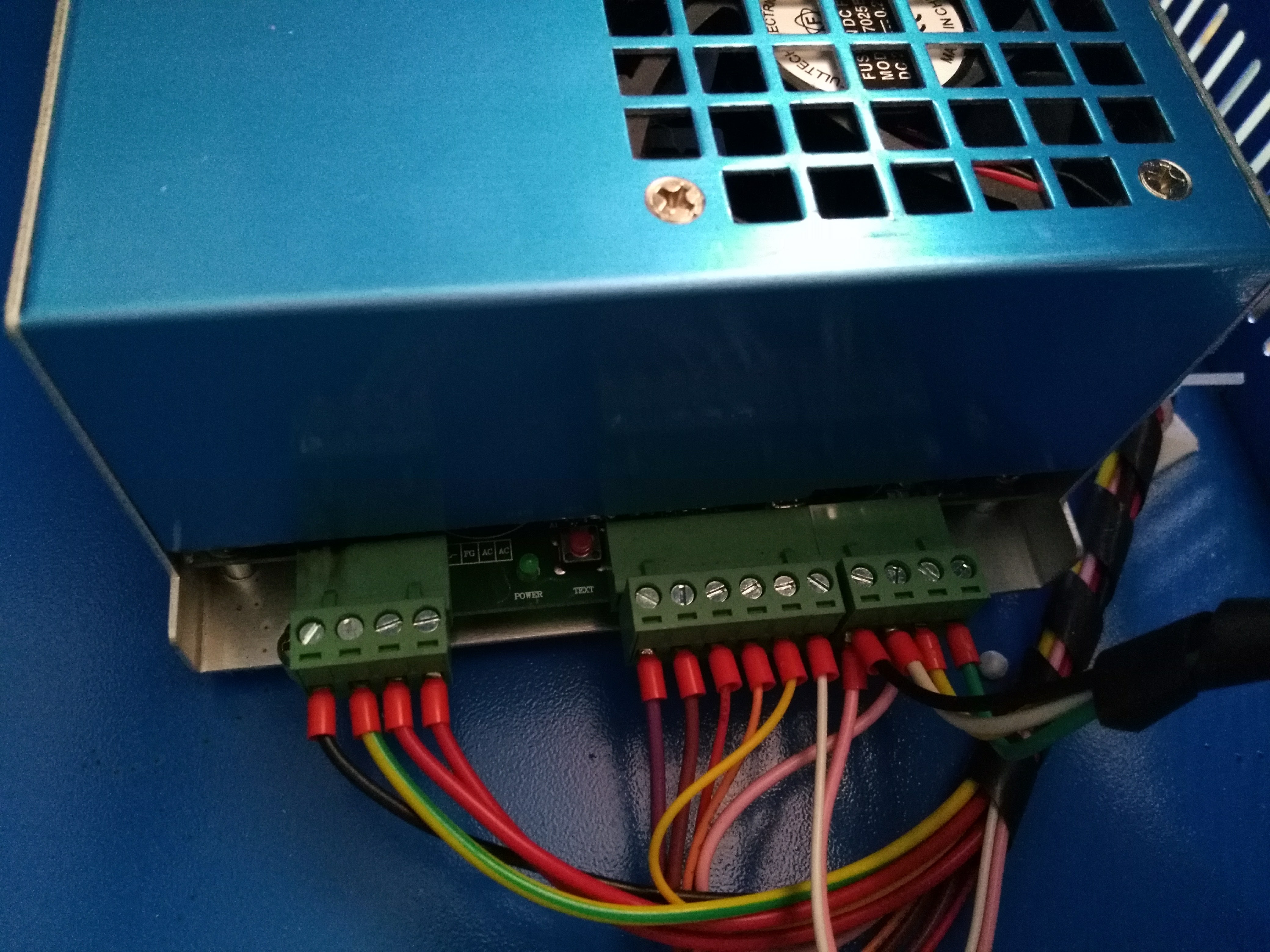

@donkjr Hi, i’m trying to find exact model for supply for spare, my problem is i have no knowledge in electronics components… have a fuse with me, will test it as soon as possible, my supply is like the picture here if you kno
w where to buy it https://photos.google.com/share/AF1QipPLOjQ3RSf2oZI6UR67ndbRTqFt7RH3_BJVGmyXKttQn3SngfuBwelz1OZapF2kGQ?key=Z0lVOWh1RzEwRzkzVWJnMXVhdm55d1E1ZmpwVHlB
@Jean-Phi_Clerc any of the 40W supply’s you find on line with the same set and orientation of green connectors should work
