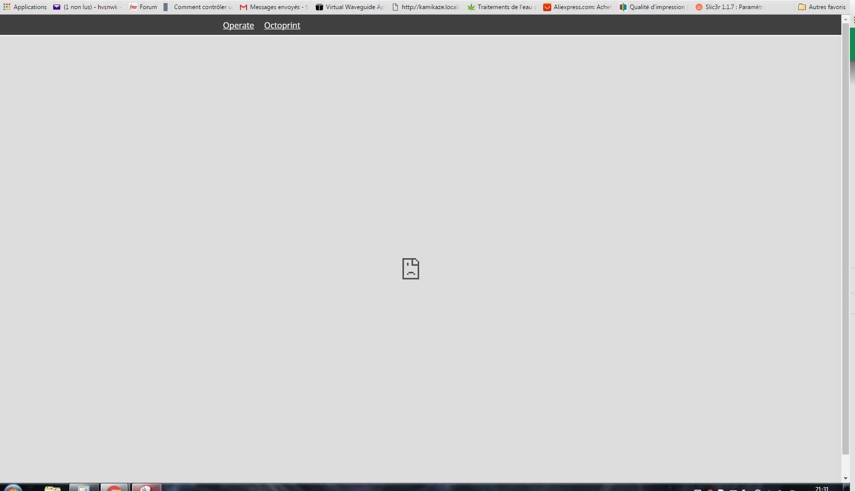

Hello I made an update with apt-get update and apt-get upgrade. Now I can’t run octoprint.
I need some help . thanks

Ok, you should probably upgrade to the latest version which has some of the packages related to upgrading OctoPrint freezed so this does not happen! Take a backup of your local.cfg and flash again. The alternative is a really long explanation:)
Also, I found when updating that if any new configuration options are added but not added to the default.cfg or local.cfg then that is one of the main reasons for crashing. It will show on the output if you run redeem from the prompt.
