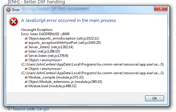

hello i tried installing laserweb 4 and got this how do i fix and it says to set pin onthe lasrweb application and i cant
@Aderito_centeio this means that there is another application using port 8000 . Have you tried restarting the computer? Is there any other app that could be using that port?
@Ariel_Yahni_UniKpty yes ty
Try this to see what app is tying up port 8000: https://technet.microsoft.com/en-us/sysinternals/bb897437.aspx
