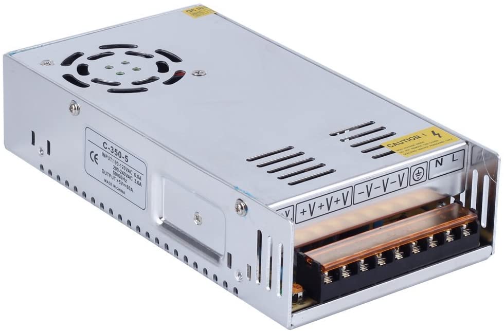

I have some question about the powering system, if my calculation is correct for about 2700 LEDs, i will need 128A. Buy two AC Adapter like this is ok for my setup ? Do you have some tips for the wiring system of the power and data signal to chain the strips ?
@Geoffrey_Legenty you need 128a only full white full power.
If you set the brightness of your build at max 128 ( which is clearly enough) you would need maximum 60a. And I think that is already a lot cause you do not display that many white pixels anyway
@Yves_BAZIN Thanks for the recommandation ! Do you have some tips or scheme for the wiring of the powering system ? Can i chain the power to the strips and have them in series or i have to power them individually in parallel ?
@Geoffrey_Legenty it’s better to power the led strip individually
you don’t want to have to many amps running through the entire strips and add a large capacitor between GND and +5v like 1000uF 16V.
