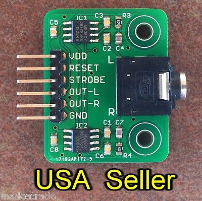

There are little boards like these to process the audio into 7 channels
Or if you get a Teensy and the audio shield it can do quite a variety of audio processing.
