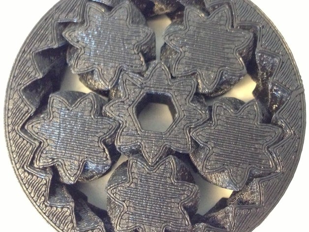

I would like the community’s opinion on an issue that my printer had from the very beginning? I believe. Essentially, the models similar to this:
would end up with gears “baked” into the outer shell, the part is one solid piece.

while i was on my quest for “perfect hole size” i accidentally found that it is a combination of extrusion multiplier and temperature. you need to print the hollow cube (0 top, 0, bottom, 0 infill) with 2 or 3 perimeters. adjust multiplier to the point you get the correct extrusion width. this should fix or at least help with your problem.
@Cristian_Nicola thank you! So, not a “spiral vase”, just the 3 perimeters(or whatever used for normal prints), right?
yes, that is correct. say you are using a .4 nozzle and you have the extrusion width set to .4 (manual - not automatic). printing 3 perimeters shell should get you 1.2mm width walls. anything more your extrusion multiplier is too high. anything less your multiplier is too low. try getting that width as precise as possible (make sure you measure on top ignoring the first layer as that one will be wider)

Simplify3d is great if you don’t mind paying for it. Slic3r is fine though. Measuring perimeter thickness like @Cristian_Nicola mentioned is the correct way to calibrate extrusion volume for Slic3r. It should also work with a single-wall box, but you might get better accuracy with a multi-wall box.

Second, an update - reducing the extrusion multiplier (based on 3 perimeters width) helped a lot. I was able to produce the part that actually can rotate.
Finally, and I have no explanation for this, but with lower extrusion multiplier value I had to adjust Z-offset, specifically, start the print at higher Z.
