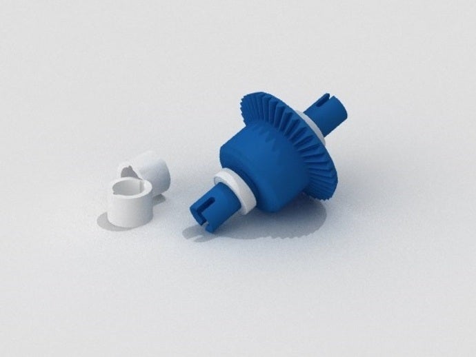

Hello, I'd like to ask. I was involved in the project RC Truggy.
Hello, I’d like to ask. I was involved in the project RC Truggy. I press my K8200. But I account with printing gears in the differential.
It is a recommended setting slic3r? To be able to print successfully complete? Setting speed, how many fills what altitude layer.
I print a nozzle 0.2 mm, 0.15 mm layer, ABS 245 * C, 30mm / s. And yet, very bad.
Thank you very much.
You will need very fine tuned retract settings and propably a well cooled hotend since the gears inside the differential require many many retracts. I printed them at .1mm layer height and had no issues so far. So what problems do you actually have?
Print is ok. Differencial printing in setting: 0.15mm layer, 0.3mm nozzle, 50% infill, 3x perimeter, top and bottom 4x, temperature hotend 195 ° C, BED 50 ° C, print speed 30mm / s, 80% speed perimeter. PLA printing material, 103% extrusion.
Slicing program simplify3D.
