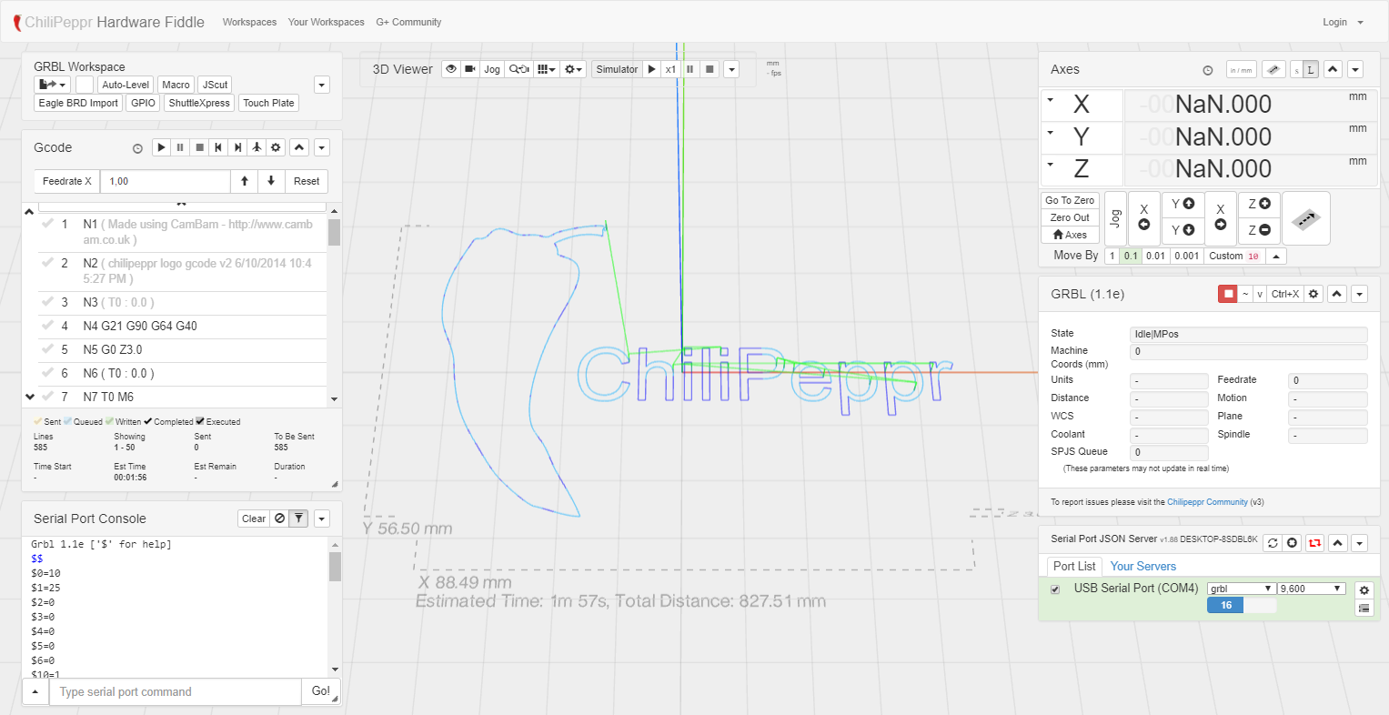

Hello,
I’l having problems with position reporting.
“-00NaN .000” , Tried grbl 1.1e and grbl 1.1f 9600 , 115200.
Anyone got this problem ?
Hello,
Use jpadie workspace for grbl 1.1
Thanks !
Wouldn’t it be a good idea to add some message to the grbl workspace saying that it doesn’t work right with grbl1.1, and pointing to the jpadie workspace - especially in light of the fact that chilipeppr’s grbl capabilities are so prominently featured? I wasted a lot of time before I found this post.
Yes, that would, but the ultimate goal was to get it merged at some point to the core /grbl workspace.
