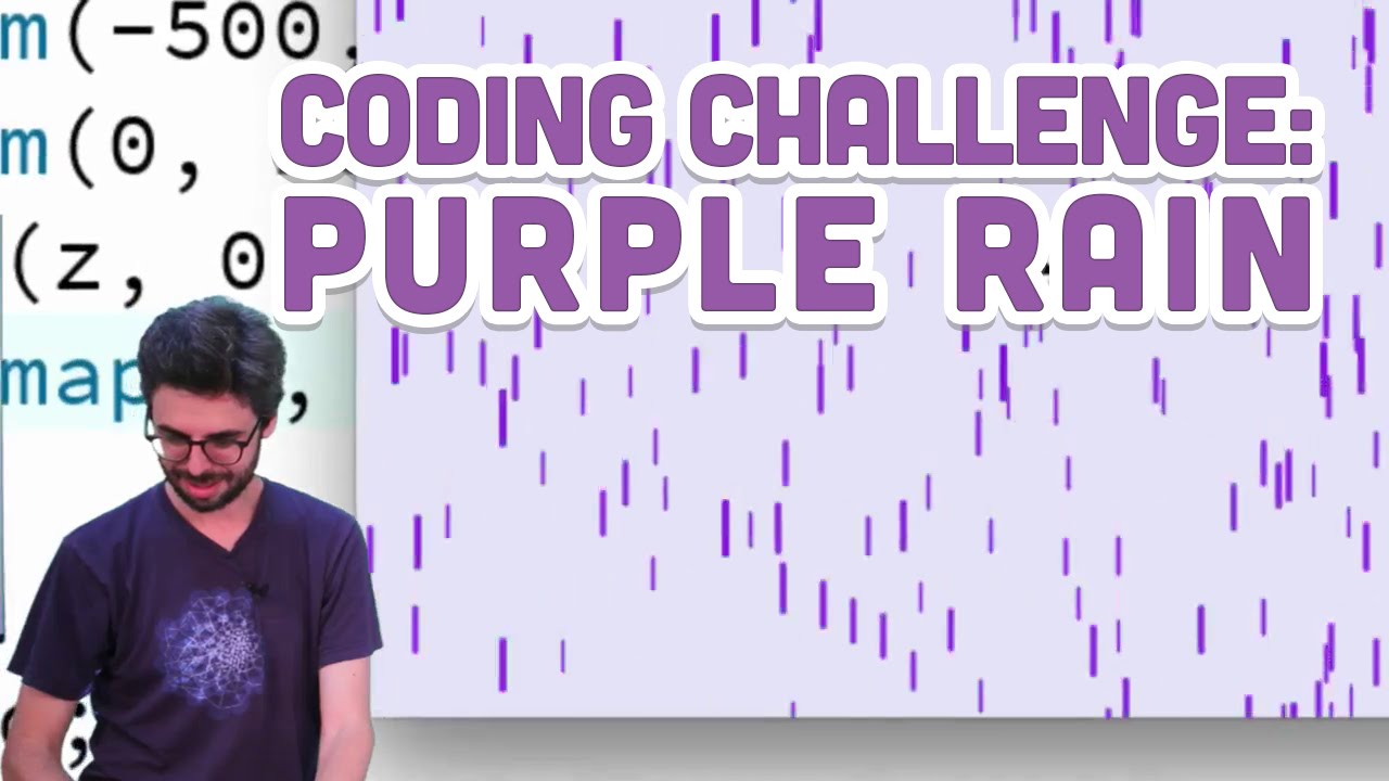

Should also note that I have been using this YouTube video as a basic trouble shooting guide. This guys has a ton of cool videos that have helped me with some of the problem solving for this animation.
