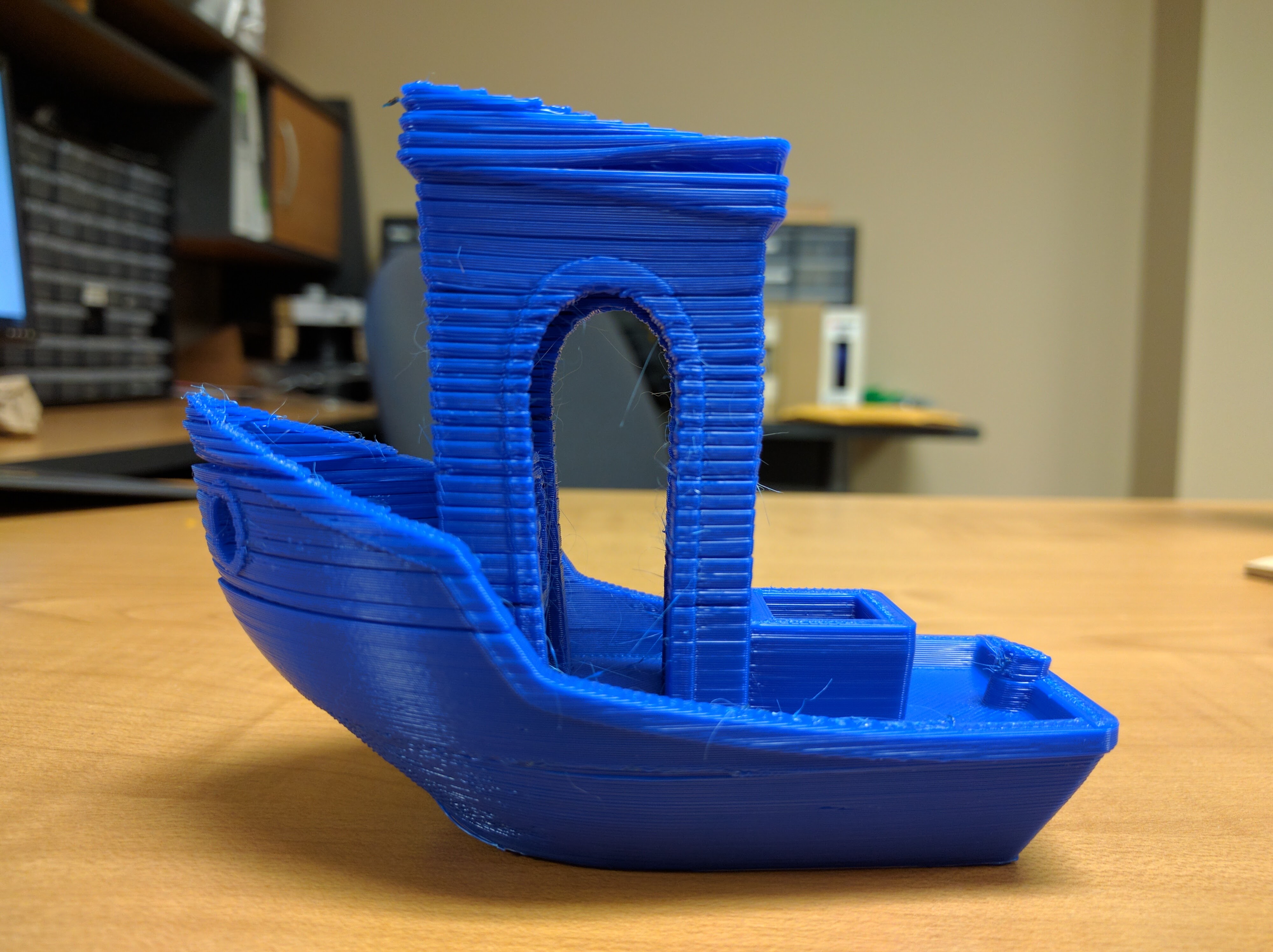

I’m having issues with a custom built CoreXY printer running with a smoothie board. I am getting growth in the Z axis on the prints. It seems to be an inconsistent issue, because I’ve printed parts completely fine without seeing it.
Usually the entire print will start with the issue, so I’ll shut down the machine and turn it back on then attempt to re-print and it doesn’t happen. I attempted to run a print over night and the issue popped up about midway through.
I’ve tried swapping motors, swapping boards, ran external drivers, power supply, and even put ferrite beads on the usb cord to see if there was some kind of noise.
I’m stumped. Any idea what’s going on? Any help is greatly appreciated.

Hmm. Well, the heat mat is mounted to 1/2" thick fiber insulated board riding on 4 linear rods and 2 acme lead screws. It’s pretty darn sturdy. I like the thought process, though. I thought it was very odd that the Z height of the benchy physically grew taller than it was supposed to be. The back window shows it pretty well. It’s almost as if the Z started moving twice as far as it was supposed to every layer. I have no idea how it would suddenly do that, though.

@raykholo I don’t think underextrusion is the culprit because I can go from printing like this in one print and completely fine in the next.

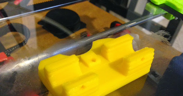

Google Photos
Sorry for the crap quality photo but this is all I could dig up of mine. Very strange and was easily solved when I switched computers. The hard drive on this computer failed shortly after which just made me more sure of my issue.
I had a similar issue for my UM2 clone,with periodic z wave pattern. People said it was caused by z-wobbling. But afterwards I figured out it was the wrong e-motor stepping per unit. I set it the twice for it should be.
