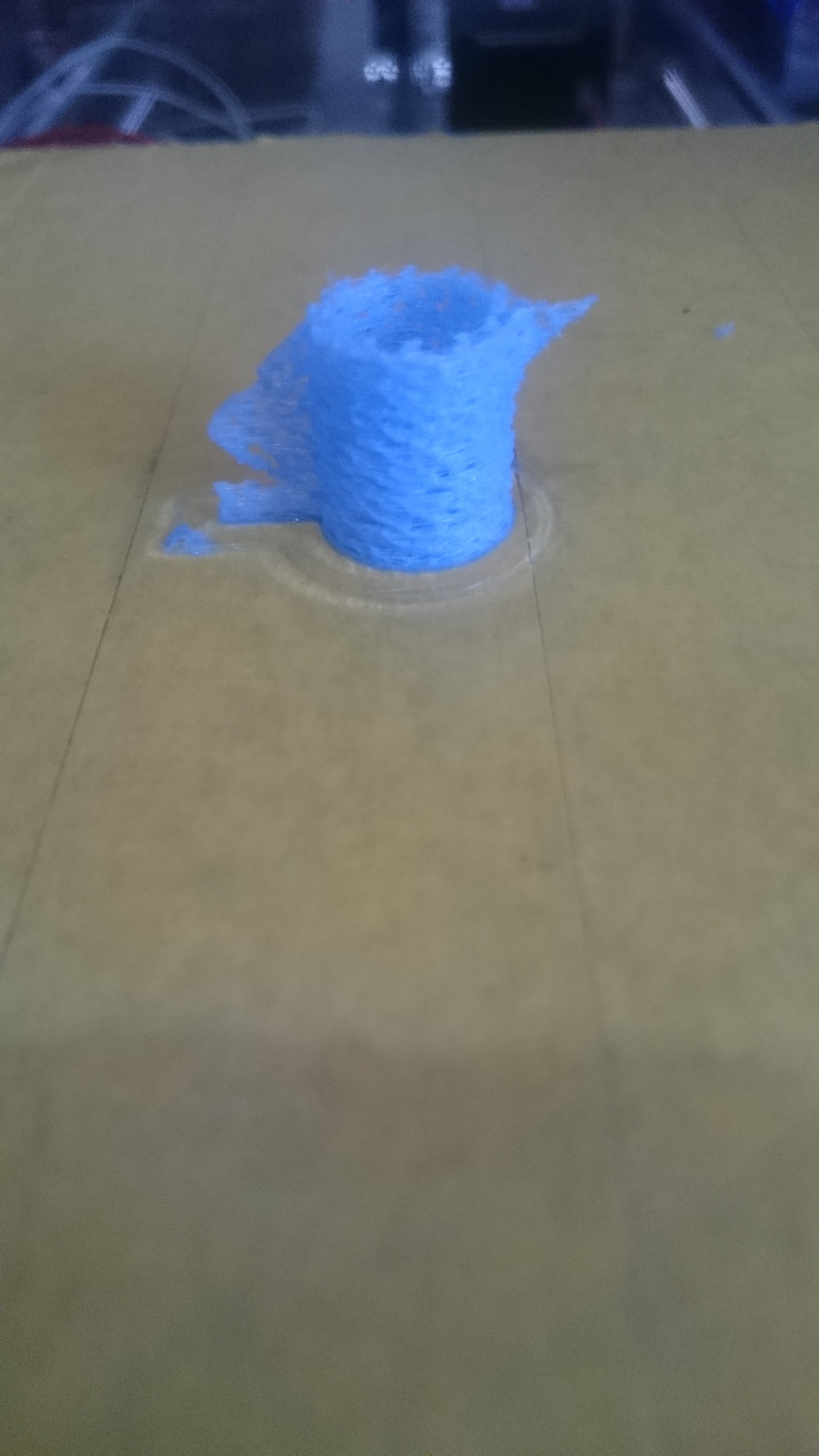

Hello i’m new here… Firstly i’m from indonesia and sorry if my english is bad. So i’m having some problem that can’t be solve… As you can see in the picture what is the problem with it?? I’m using pursa i3 (from china) printing speed 40mm/s. Thank you for your attention :3
Wow. Not even a normal layer. First thing coming to mind is to much temp and or under extrusion
Have you calibrated your extruder?
Oh yeah i did just now… And the result is good already… But now i got a new problem the filament won’t comeout from the nozzle -_- i think there is something inside that is blocking the flow… Any suggestions how to clean the extruder its an e3d v5 i think…
Google is your friend there.
Looks like you’re under extruding or that your print head is jamming.
Yea I have a pursa i3 and it does that after 5 or so prints and the only way to fix it is clean out your extruder and the area around it.
The problem with the pursa i3 is the extruder is right next to the nozzle so the plastic when heating up and extruding plastic splatters the plastic all inside the extruder compartment. So you have to clean it out
