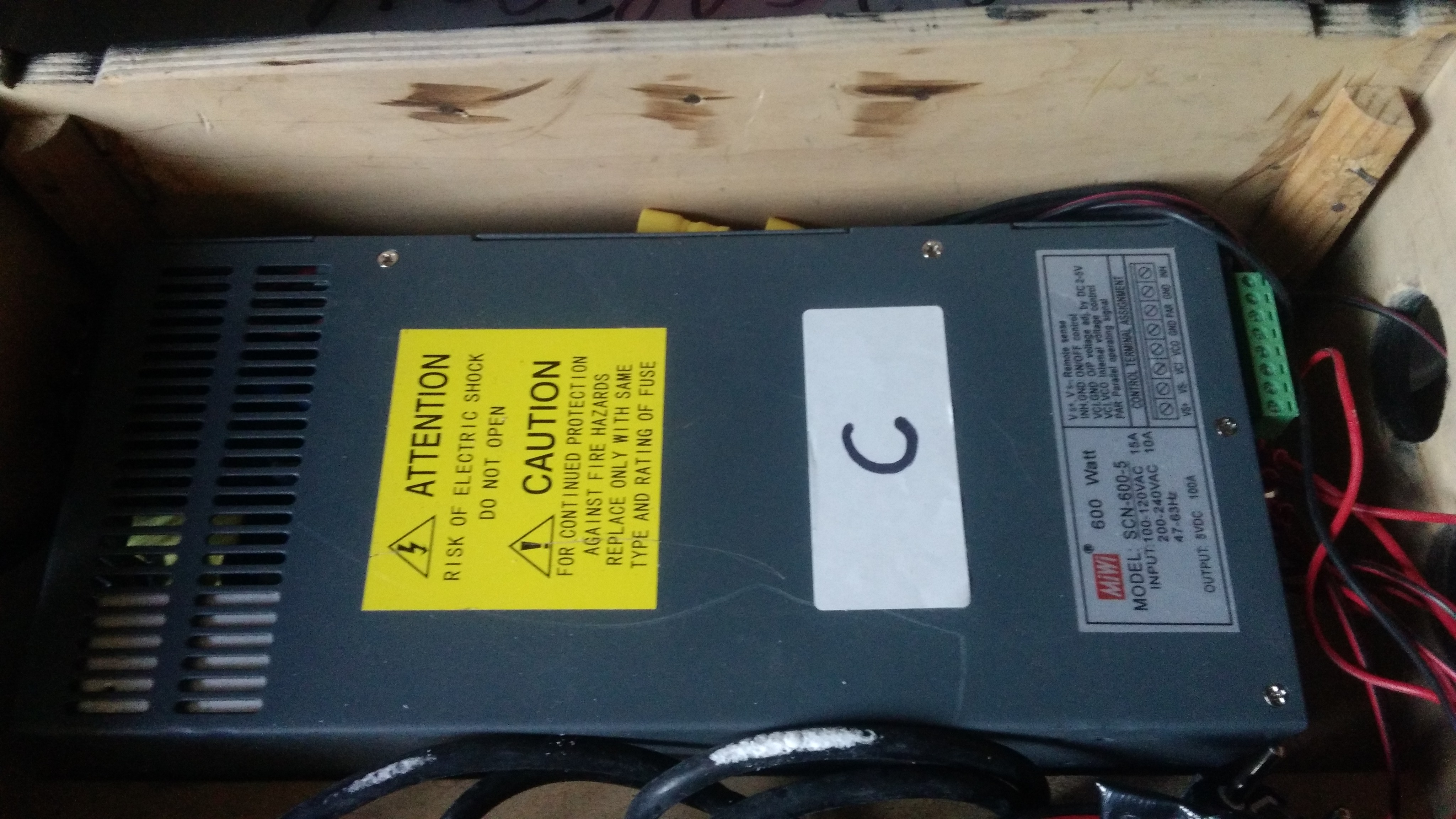

Hello, I’m starting with one meter / 60 leds WS2812 ledstrip + ATtiny 85 and that works fine with FastLED. However I wonder why all my leds are turning to yellow/red (not only the far end) when the potentiometer is turned to max … since I’m using a big power supply as you see in the pictures (+5V 100A !). Any help would be appreciated.

@Derrick_Giscloux Indeed it happens when the potentiom. is full open then I get around 2.5V at each yellow/red pix and the brightness seems at its maximum. Below that everything goes to 5V with a normal white and things slightly dither near to shutting down + the potentiom. has a on/off switch @Mark_Estes you found a error in Fritzing thx
