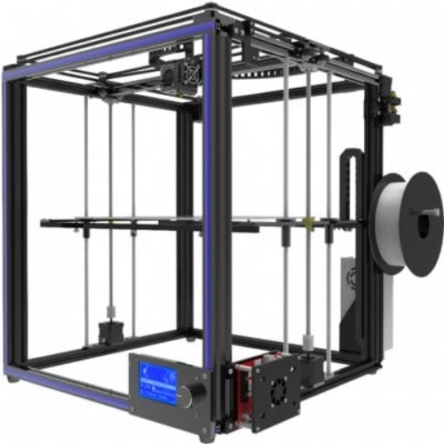

The frame of this printer is sturdy. I can only comment on the printer itself though.
It is precise and once setup, it is ready to print without having to calibrate anything.
Though…
When the printer is powered down, and you put a little pressure on the bed, you are able to push it down. Since there are 2 Z motors, one can be pushed down more than the other and your bed will hang skew.
So don’t touch the bed when it is not powered.
Allthough it’s a cheap printer, it is quite a good quality of printer and prints.
@Mano_Biletsky_Open_M That’s because it uses a lead screw with a lead of 8 mm. Use 1.25mm pitch screw or 2mm pitch screw. I have printer of 500x500 with M8 screws
