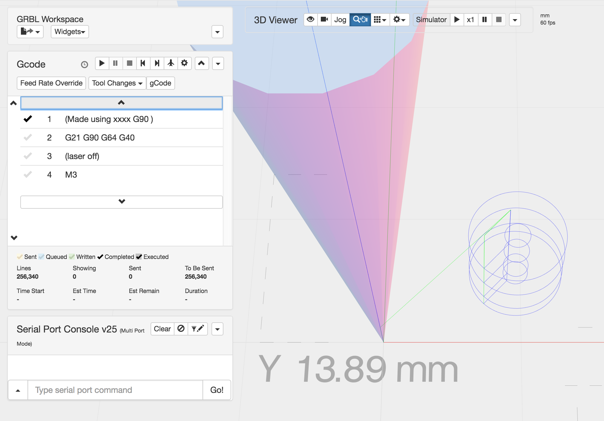

Hello! I’m trying to run a gcode file generated by the current version of Carbide Create (313) on a Shapeoko 3 running GRBL 1.1. I’m using the “jpadie” version of ChiliPeppr, on OSX, with Chrome browser, and serial json server 1.95, compiled from GIT checkout, on the same computer as the browser.
When I drag the file onto the ChiliPeppr window, the “drag a file” prompt appears - but when I release the file, the file isn’t loaded. I can only load the file via the GRBL Workspace menu.
The preview looks correct…but if I click on the play button to simulate, the virtual tool slowly raises, and then ‘slams’ back down. That’s it. Does it on multiple gcode files I’ve generated with Carbide Create.
The gcode ‘widget’ shows 256,000 lines loaded, but my gcode is only ~900 lines. And when I click the “play” icon in the gcode widget…nothing happens.
I am able to send the default gcode chilipeppr opens with, so generally speaking, gcode sending works. And the file sends OK with Universal Gcode sensor, so it doesn’t seem like the gcode files I’m generating are invalid.
