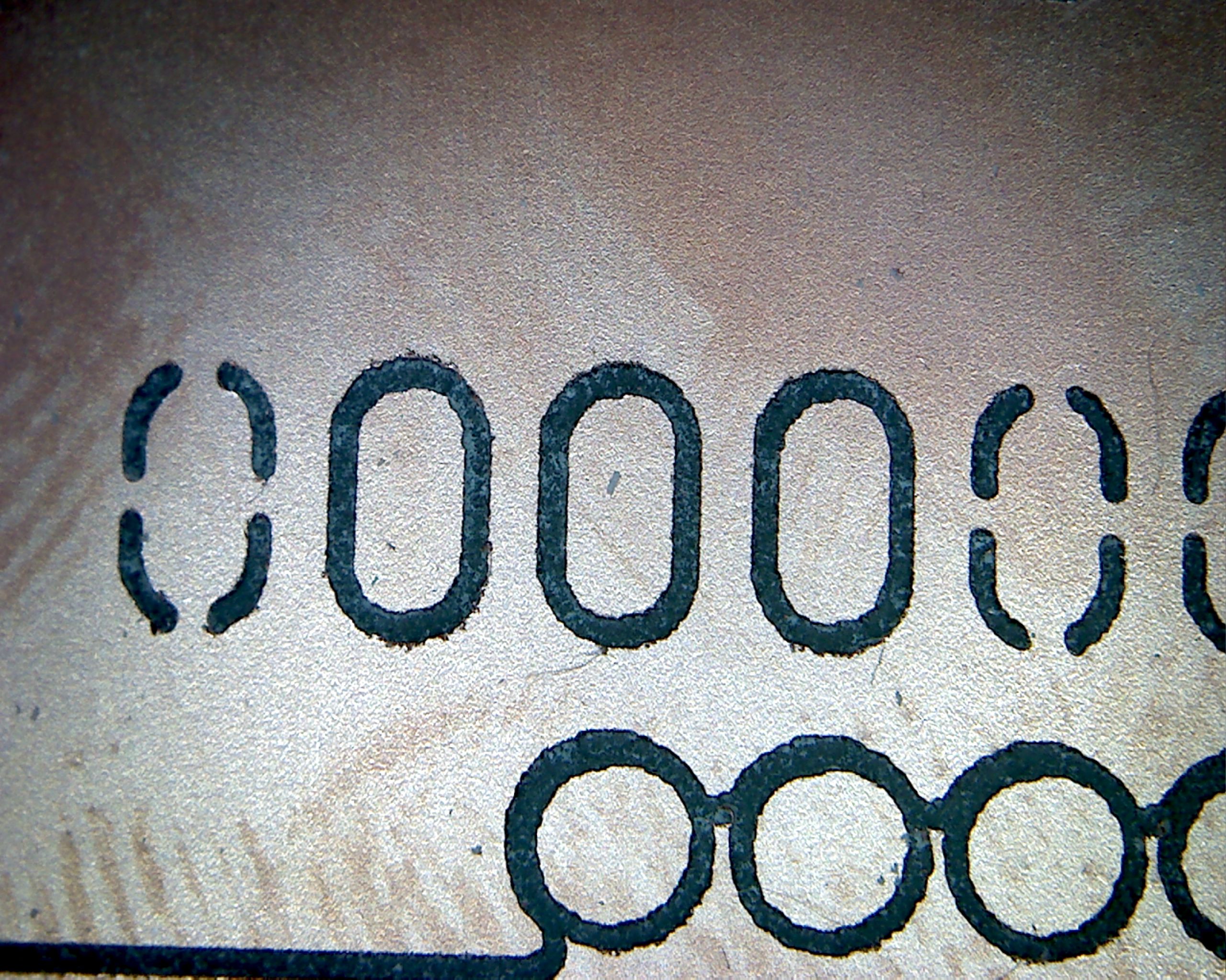

The problem is that after I run the autolevel, and apply it to the PCB gcode, and then engrave the blank, I get consistently poor results: the engraving bit is being lifted off of the surface of the PCB in the same place across many PCBs. I’ve run this test a half-dozen times on different blanks. I’ve tried every 3, 4, and 5 mm. I’ve reduced the probe feedrate all the way down to 0.5 (not sure how small the steps can really get).

I’ve attached images below of two PCBs:
Photos withb Autoleveling OFF (just zeroed with “run test probe” and started) shows the copper correctly engraved and autoleveling ON (showing leftover copper).
