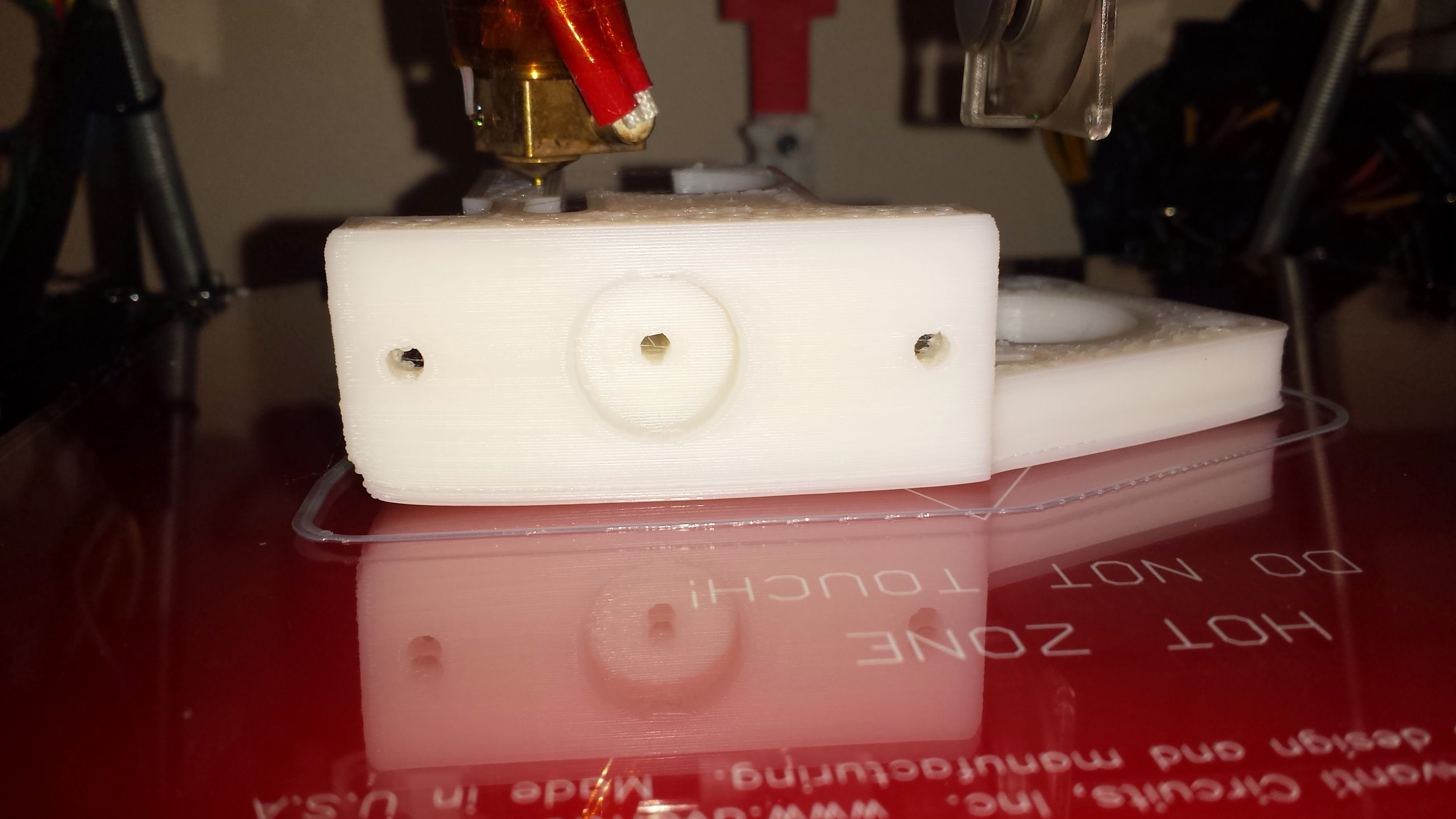

Hello, It seems like plastic doesn't stick to my heated bad.  I started to
Hello,
It seems like plastic doesn’t stick to my heated bad.
I started to use 3mm brim around element - but I had times where I was able to print without it.
details: PLA 200 C, heated bed 70 C (already raised from 60 C because of same issue)
I use clean paper towel with rubbing alcohol on glass before printing.
It may vary from filament to filament.
What else I can do beside brim 3mm ?
