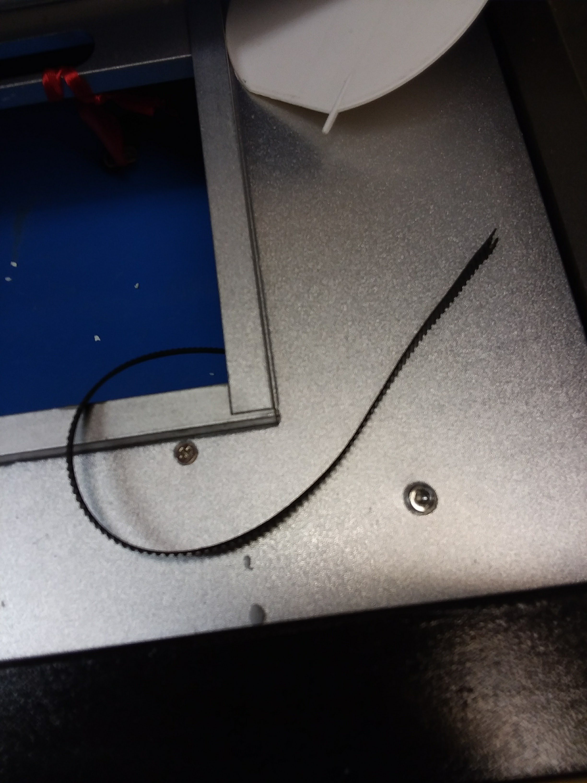

Hello, just joined your page, thank you for having me, I just purchased my first K40 Laser, got it Friday and when I unpackaged it, the Side Belt, had come lose on one side and was laying in the bottom, I have no experience or knowledge about this machine, is this a hard belt to repair ?? if needed replace ?? for someone with no knowledge of this and it’s operation ?? I am a small Mom and Pop Woodshop, who wanted to try something new and hopefully expand my small business in a new direction, I pray this wasn’t a mistake, any suggestions or advise is greatly appreciated.

From what you described I’m thinking the head mounting screw. The belts are not a loop but a section and the sections are held together with a screw that pulls the head around or bar being the sides…Y axis belt… there are two on that axis.
Should be a fairly easy fix but may take some effort to get to. As Nathan said, pictures would help us to see for sure.
I believe your right, because the end that is loose, looks like it may have been screwed down, has a Horseshoe type end on it, being from the side, that moves the machine forward and backwards, I just need to figure out how to get to it

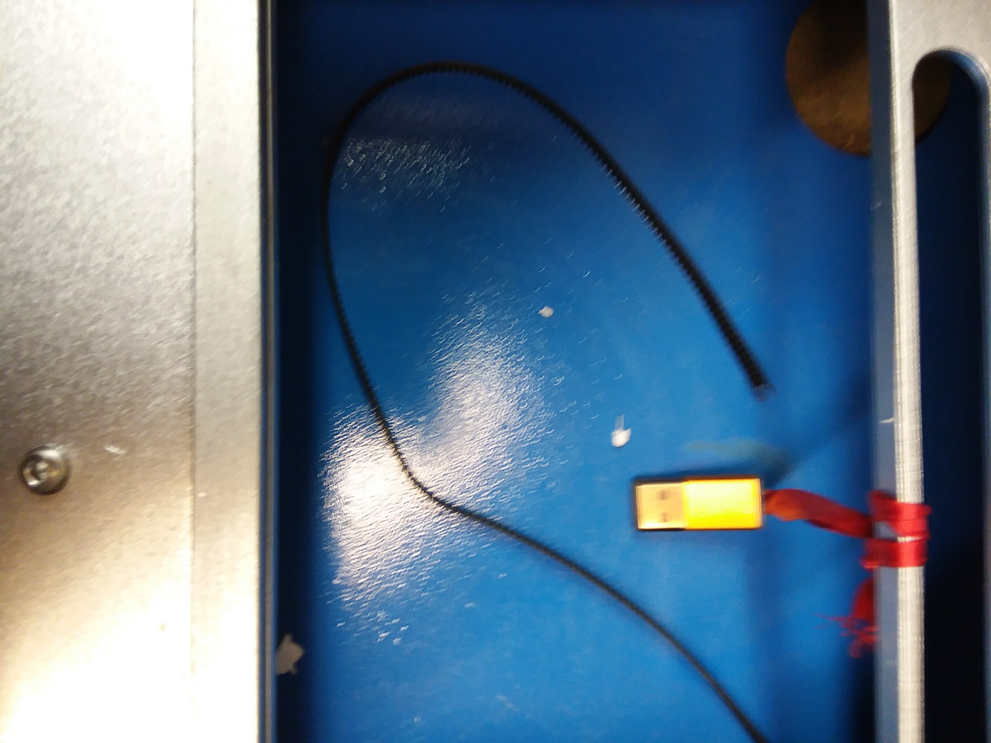

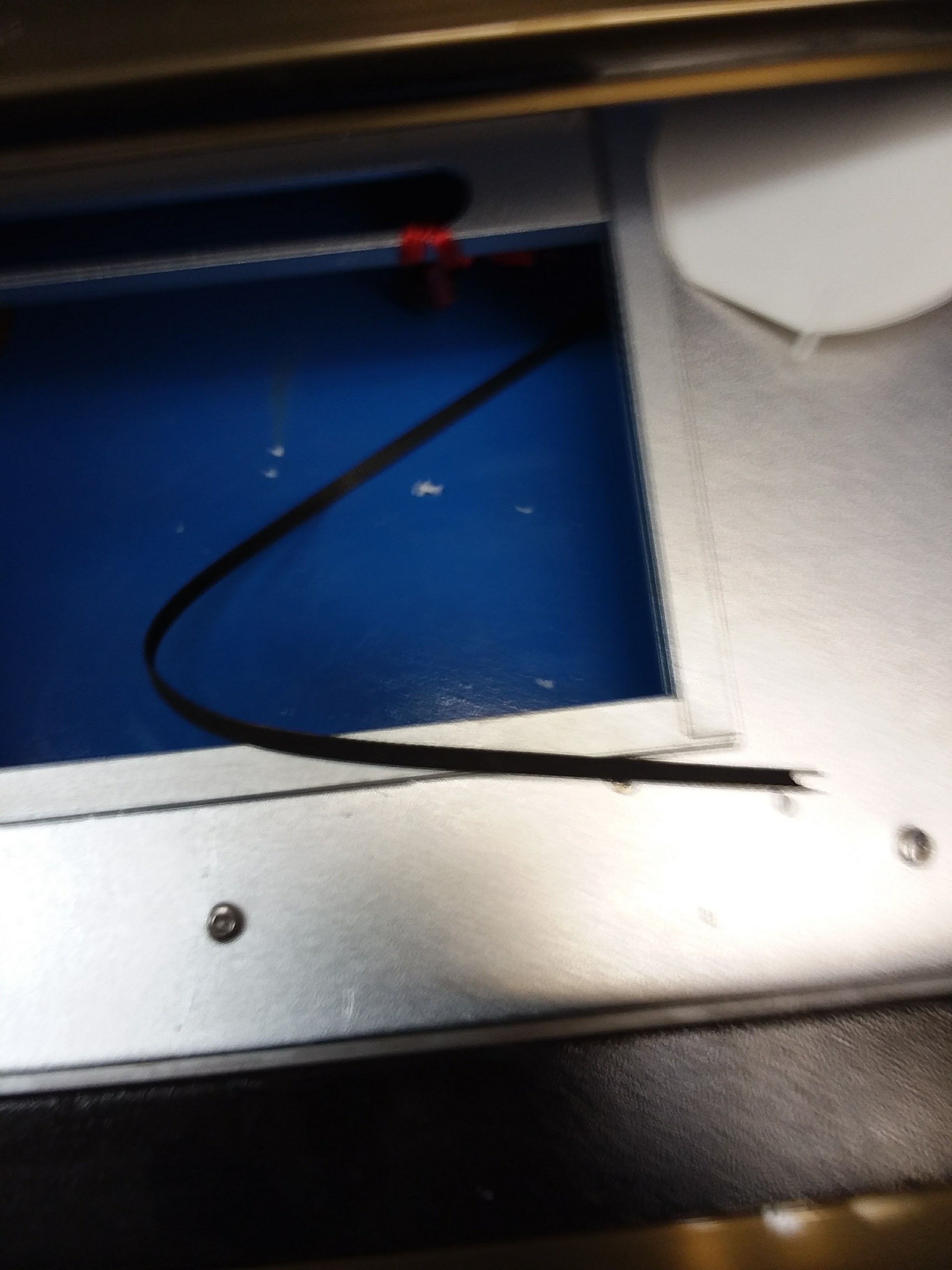

@Nathan_Thomas here are 3 different photos of my belt and where it seems broken ?? or come loose
If the remaining belt section is now not long enough because it has torn loose the simplest thing would be to order this from Laserobject
