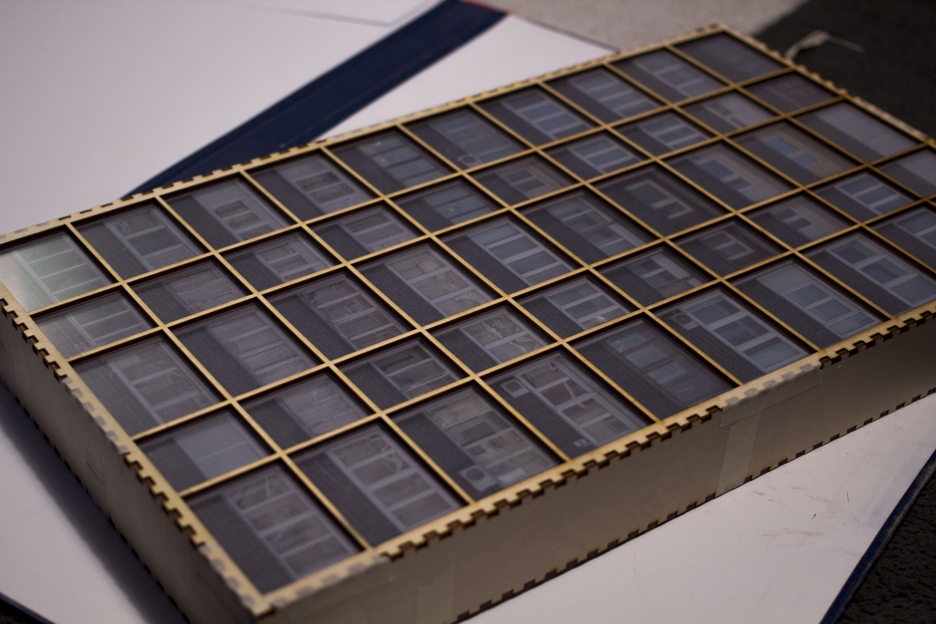

Just started a project with some rgb leds.
I cant find a simple example for a LED matrix, where i can simply define the leds i want to light up the same time. I want to make simple custom patterns. Is there a way to make these patterns with arrays?
Like i have a matrix: 10 rows, in each row 5 leds, connected in zigzag. And use an array like this:

And maybe change the colors individually?
I want to make a flat house, with lighting Windows:)

There will be two potmeters on the side of the boksz, so you can adjust it, and the lights will power up in random patterns. This is going to be a “controll table” for a video.
I’ll back if figured out the code or not!
@Mate_Varga HO refers to a modeling scale, commonly used with model railroading. I was wondering if that was an HO scale model building.
@marmil Oh, okay! No its not an HO scale. It’s just a random size, that fits to the printed image. Dont measure the scaling yet. I’m just got some help with the programming, and made a very simple starting code:

So I’m gonna use this to make the patterns with the right color.
Just build my first matrix, but wanted to say I wouldn’t code like that. It’s going to be insane for you to re-color having to change all of those individual values. My [still-quite-novice] instinct would be to at least have an array of color values (maybe just hue to keep it simple) and then cycle through your leds to set them. So you set the colors once (or programmatically) and then just assign them in a for loop.
