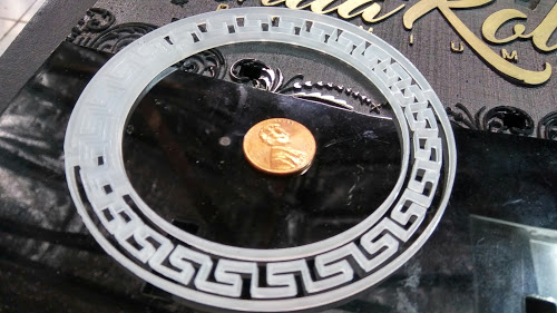

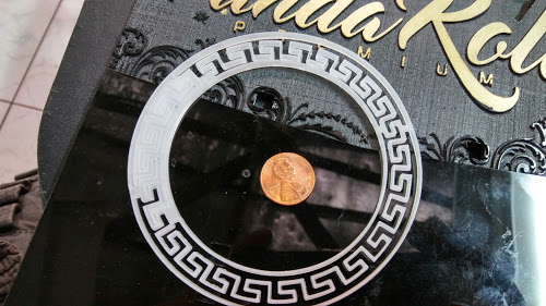

EUREKA! Finally got it. it was a short battle of settings and finally got it… WOW! so excited to have control of this machine for now… :slight_smile: Thank you!!! ill post what I make in the next two days.
Yuusuf heres whats xome out the k40 with corel draw. Thanks for the help!
@Gideon_Sauceda Nice work :slight_smile: Hope to see more of your work in the future.
