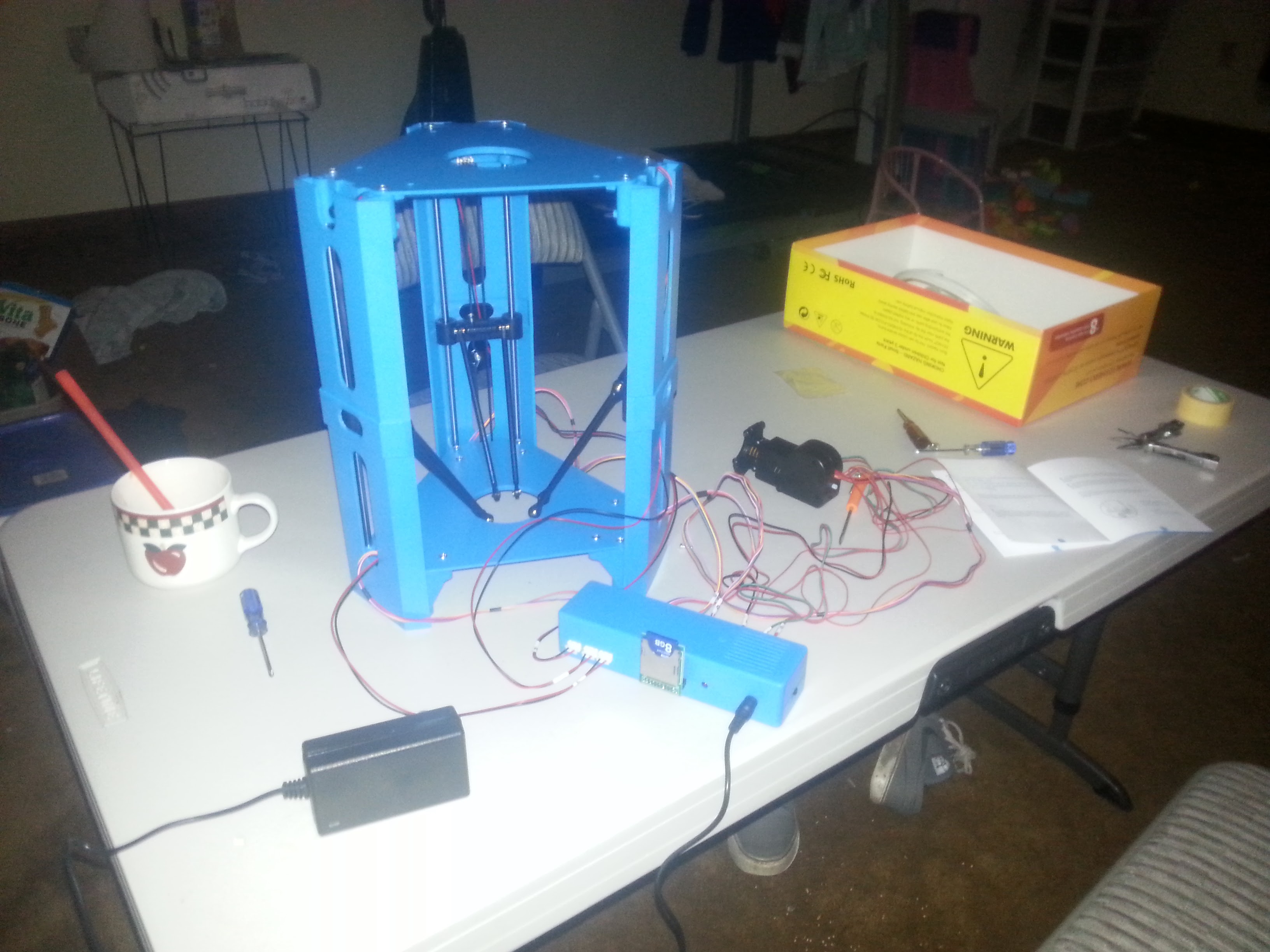

Hello my brother and I got a hero101 3d printer a few weeks ago
Hello my brother and I got a hero101 3d printer a few weeks ago and it’s almost done we just need to add the extruder and it will be done but the arms that hold the extruder are way to low to put it on and we have not yet been able to put it on

Looking at a picture of a completed hero the bottom of the print head attaches to the arms so you should just be able to attach it with the arms at the lowest position as the print head is ABOVE the ends of the arms.
When you switch it on it will move the arms up
@Lurch_Lurch666_666 ​ now that I look at it you might be right But when I tell my brother he says the we should raise the arms and if I knew how to put the screws on the extruder then I would do it my shelf

@NathanielStenzel Its just a really cheap delta printer. Parts are designed to by injection molded as cheaply as possible, tiny motors use plastic gearing to improve torque, and the hot end / extruder is supposedly a 3D printing pen (or at least that is the source of the parts).
As for the sensors, 3 end stops at the top of the 3 towers, just like a normal delta printer. At least from what I gathered from the Makers Muse video.
