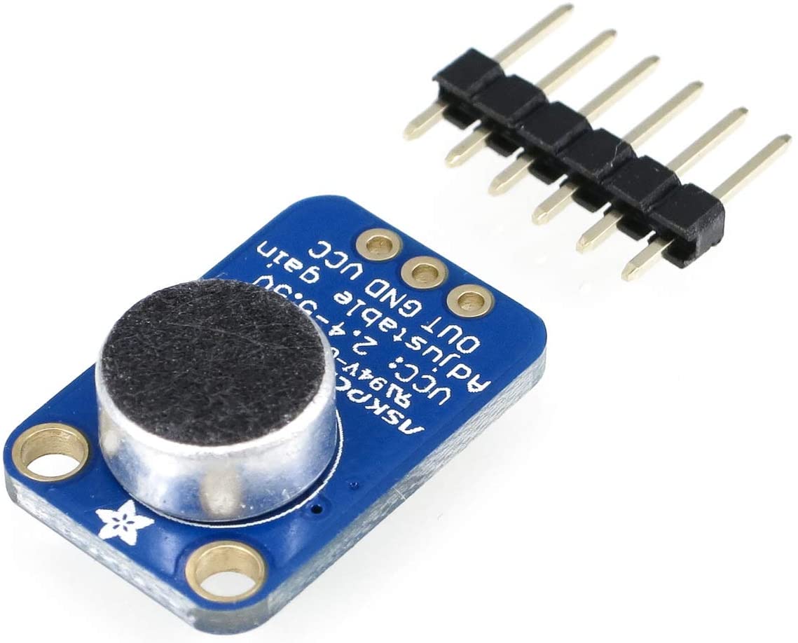

Hello my name is Kev,
Hello my name is Kev, I am wondering if I can use this microphone amplifier
with a Adafruit Flora
to control a RGB neopixel…

I think I have one of those, and it didn’t work out well for me. Certainly, the aliexpress sound sensors are the worst. I have had very poor luck with anything other than:
It runs off of the 3.3V line on an Arduino UNO or Nano and has a gain of 67db. If you DO get it and it works for you, I’d love to hear.

I have used quite a few of these and they have worked quite well.

@PandaRiot779 ​ the Adafruit flora may work for this but stay away from the arduino lilypad i could not get it to work with fastled to save my life. And even with the neopixel library i could only get patterns to work when clocked to 400KHz not the regular 800. As far as the microphone its a great one ive used it before.
I helped a friend successfully make this, which uses what looks like the same setup: https://learn.adafruit.com/ursulas-seashell-necklace/overview
