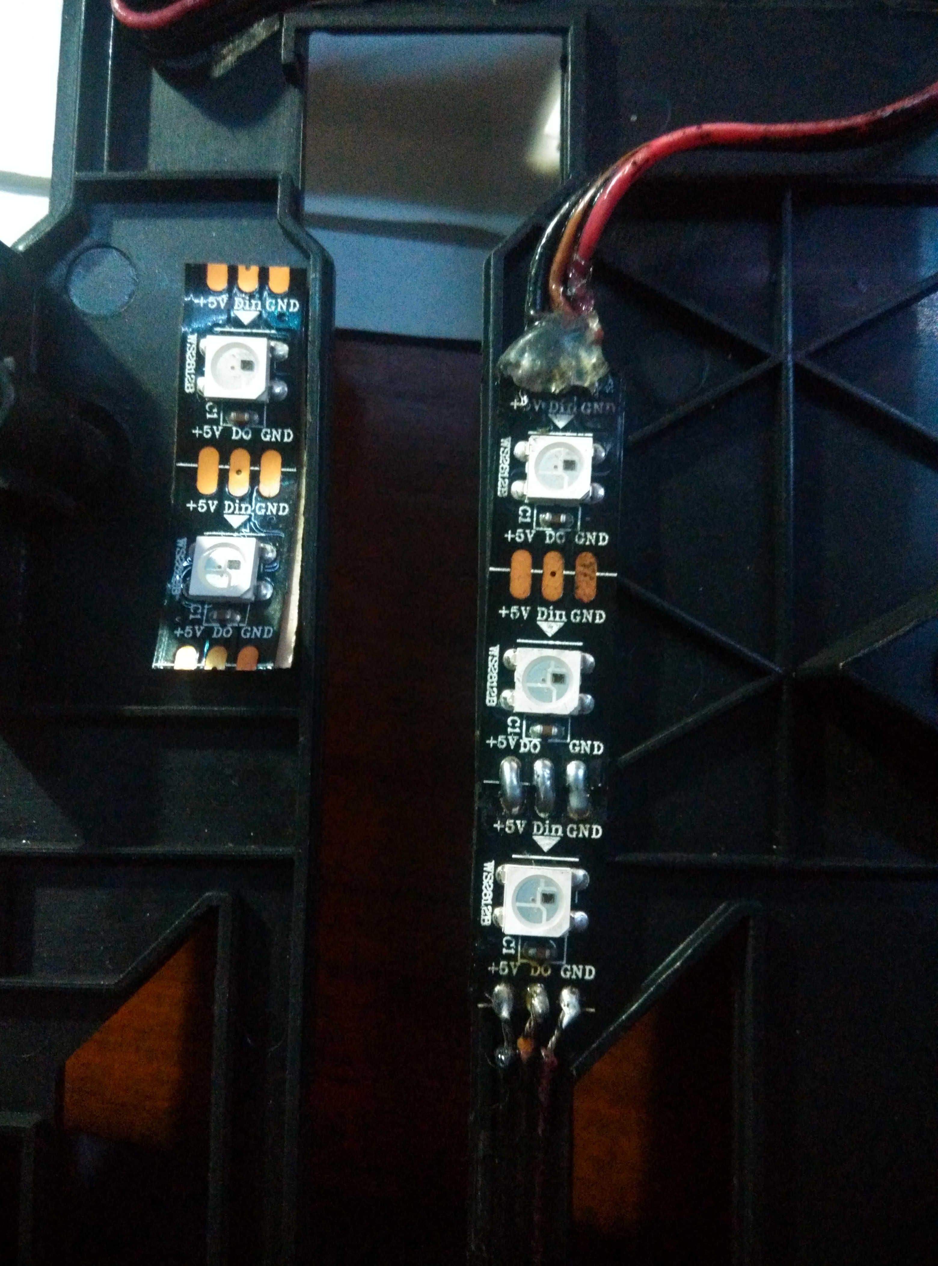

Hello, need help Will it work if I connect them in parallel Led-ws2812b
Hello, need help
Led-ws2812b
What do you mean by ‘work’? If you connect them in parallel, those strips will receive identical information and thus look exactly alike.
If you’re having the LED’s blink in order or similar, there’ll be a pause in the 2-LED strip while the 3-LED strip does whatever with the third LED.
If you want both strips to render identicaly,yes it will worm
I had to put a diode at the data inputs when I paralleled several rings together… Otherwise I got errors from some kind of feedback in the lines…
I am running rainbow effect.There are total 17 leds.My question is both strip will receive identical information or not or there will be a problem
thank you guys for the help :slight_smile: it working
