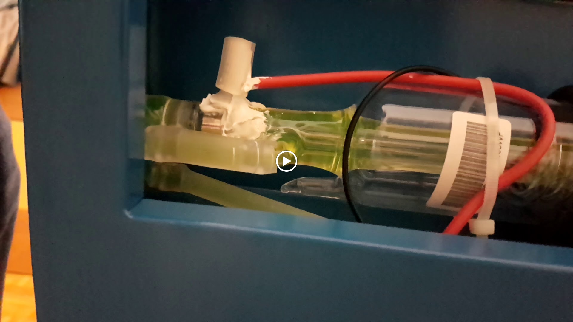

@Niels_Picciotto Have you solved the problem? If so, how did you get it? Today was cutting without problems and suddenly the laser has stopped working. It makes a kind of whistle similar to the one you describe. I was using distilled water and reading the comments you make and @donkjr article, I’ve removed all the water, cleaned the tank to remove the algae and added a water mix with RV antifreeze in a in a ratio of 3: 1 /2. I left a while circulating the water to act and pressing the test button, the whistle continues to sound, but the laser does not work. Does anyone have any ideas?

Have you checked for arcs?
When you say stopped working do you mean the tube does not light up?
Can you post a video of the anode end while operating.

@donkjr . When I say that the laser does not work, I mean that when I press the test button, nothing happens. There is no light inside the tube and there is no laser beam. That’s why I can not make video to show you the problem or analyze if there is an arc in the anode. When the thermal paste dries, I will return to the tests and comment the results.

This is the video of what happens on the anode side of the tube when I press the test button.
