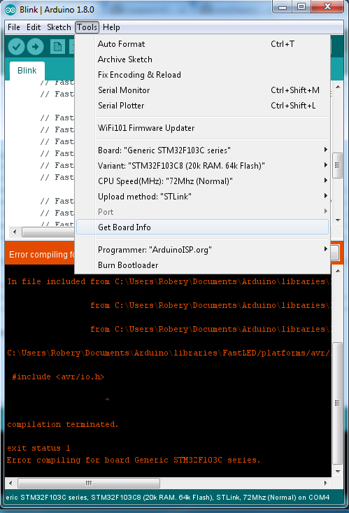

Hello, please help me, can it FastLed library support board STM32F103C8T6 ARM STM32,
Hello, please help me, can it FastLed library support board STM32F103C8T6 ARM STM32, I use software arduino but always appears error like this :
It doesn’t at the moment - you might be able to tweak the stm32 support that was done for the spark core - look at the PORTING.md file in the library and the code files in platforms/arm/stm32
