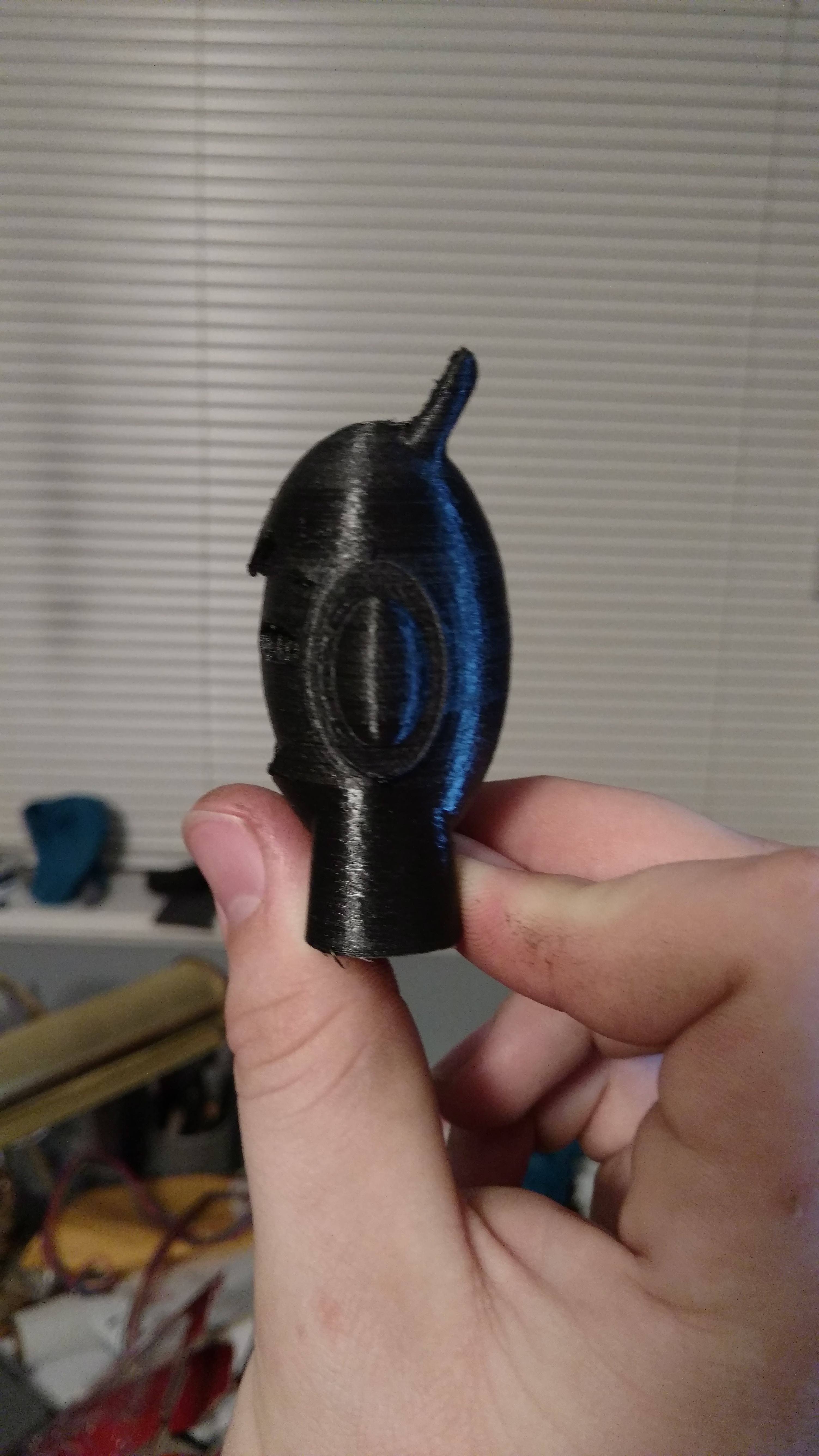

Hello, So I did another test using a Marvin This is what I got
Hello,
This is what I got
I looks like the print got stretched when it was printing?
Any ideas why it did this
I’d guess steps per inch is your issue? Either Z, or both x/y (assuming its proportional in both axis?)
@jerryflyguy Does starting g-code have to do with something with this? I think I have my X steps per mm at 80 and my Y is at 120.
Have you made any calibration cubes or items you could measure ? I’d start there, that way you could measure the final part and figure if it steps or what.
Not sure about starting gcode. There are M codes for scaling various axis in milling but no idea if it is used in printing ?
Will do.
Thanks for your time
@jacob_keller anytime! Not sure I solved anything but hope it helps? something to check at least?
