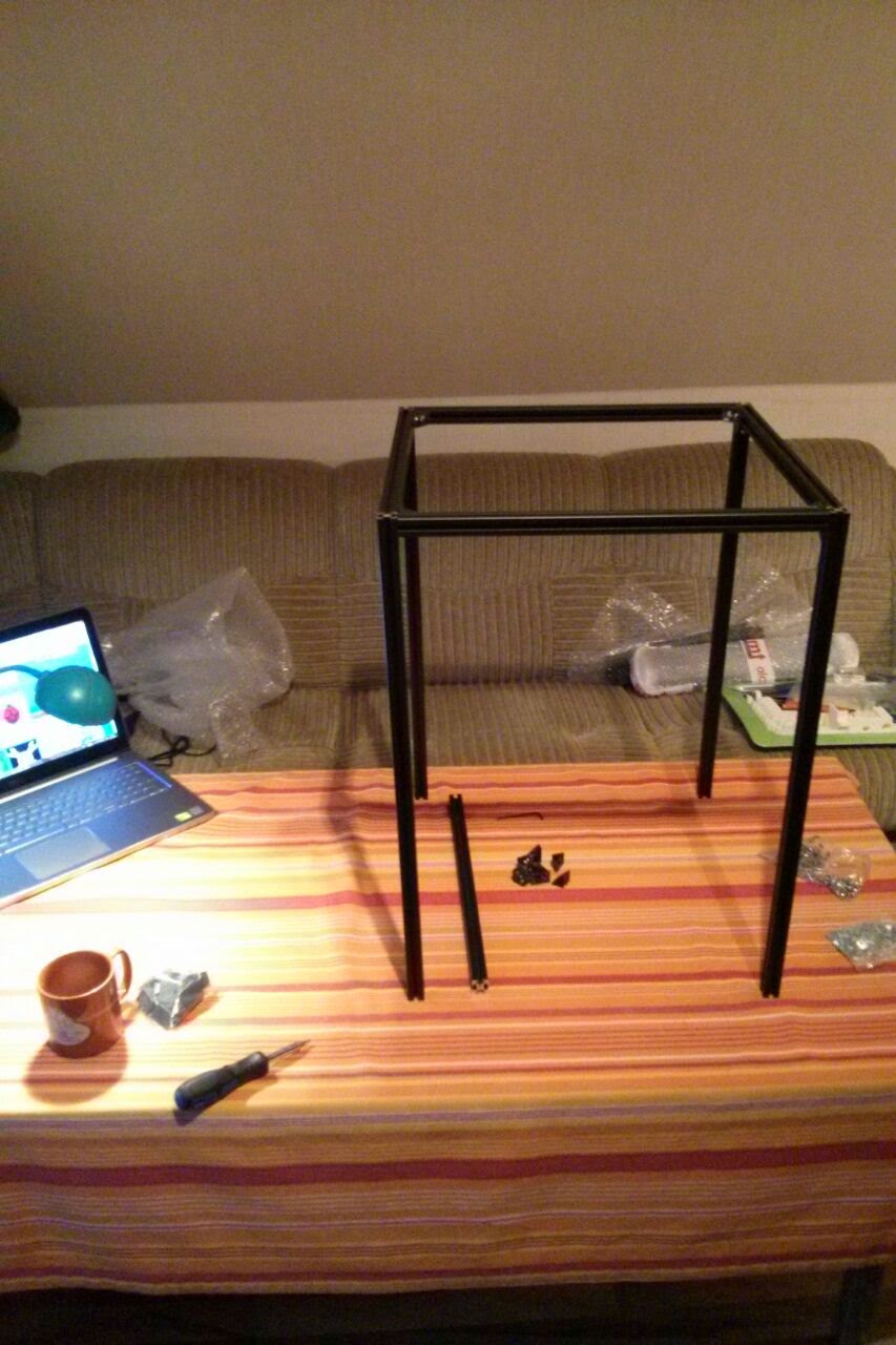

I just started my build of Eustathios today. I have some questions about the pulleys. The 32teeth/10mm ones are hard to get. Has anyone experiences with other dimensions of pulleys? Or is there an other source for the 32T/10mm than aliexpress?
I will also be happy about some suggestions for shopping parts like belts/bearings/motors/hotend.
FYI: the parts for the frame are ordered at http://www.smt-montagetechnik.de/ (see partlist pic).
