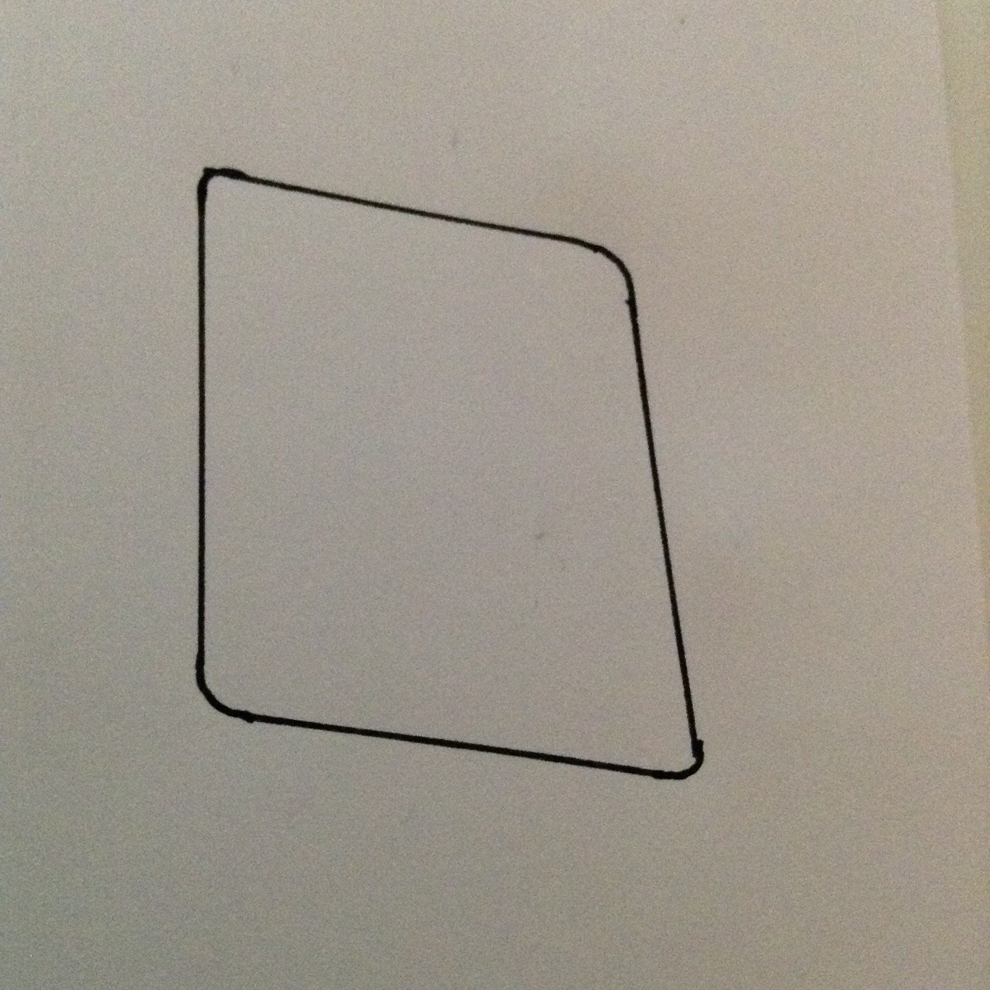

i am new to laserDRW 3 - i am trying to make this figure to cut in wood but i am not able to do this form…
Is there any other way of do it if it is not possible in laserDRW
Can someone help me?

Well, how accurate do you need it?
This is made in CorelDraw. The black is your sketch that I traced over in orange.

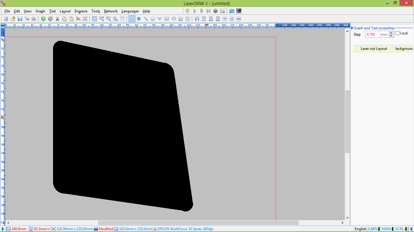

And this is in LaserDRW. Once again I opened your sketch and used it to get the sizing.
It’s a circle in each corner, a thick line on each side, and 3 shapes filling the center.
The laser will just cut around the outline.
Thank you very much for you work and explanation…
only now i realize how t do it… Best regards and once again THANKS
