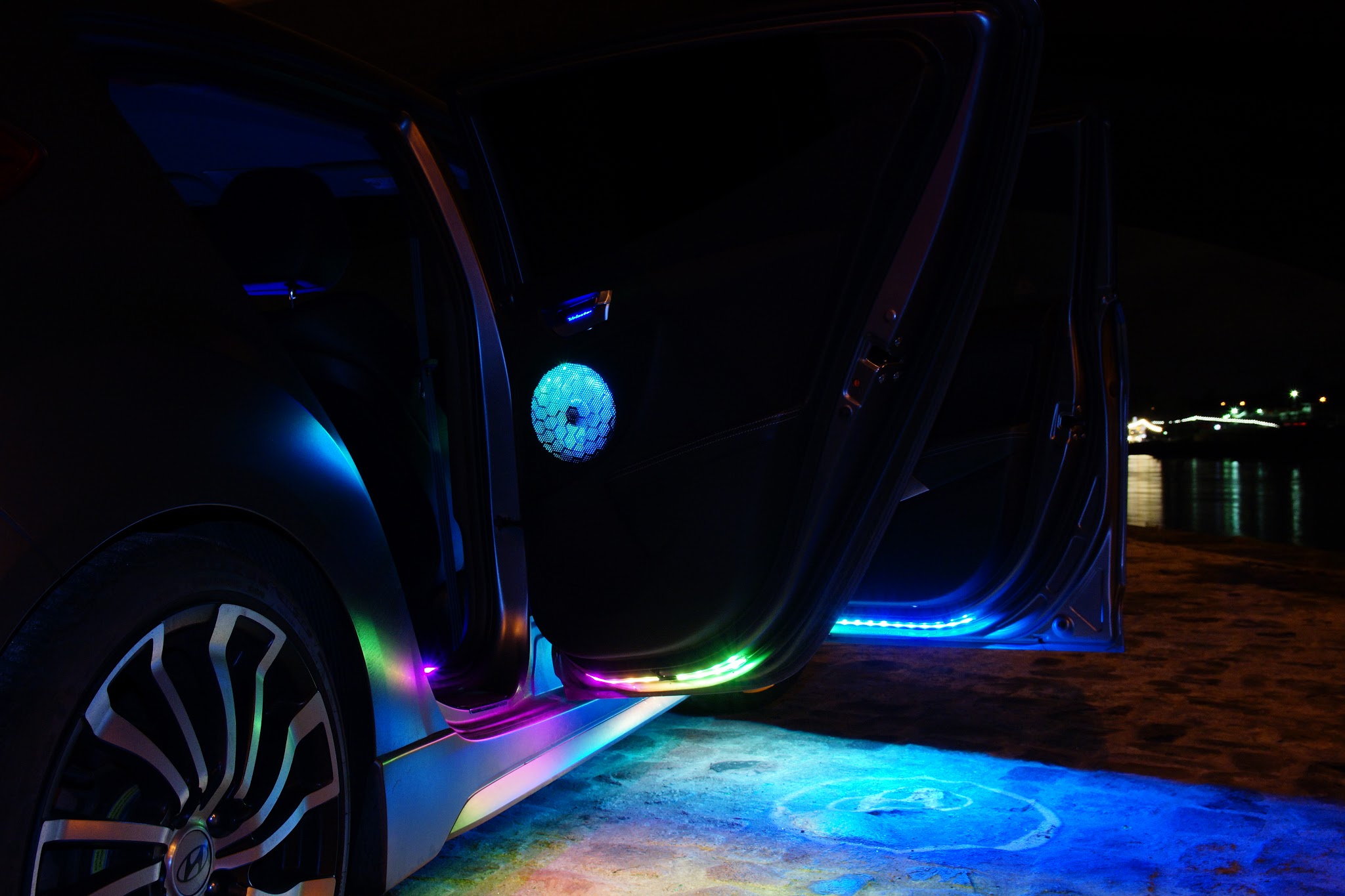

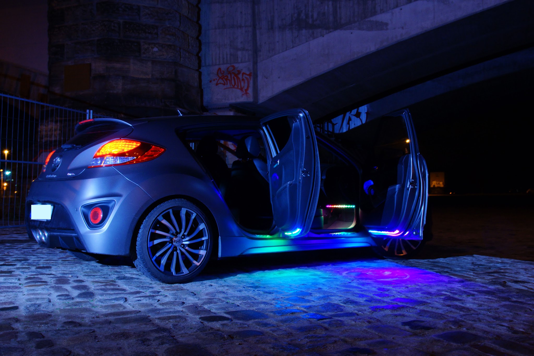

  1. What is my project?
    I have installed 2 or more Led Stripes in my car one from the footwell of the driver side up to under the door. The same on the co driver side with another Led Stripe.
  2. What is my goal in a simple way?
    In a simple way I have a specific color or gradient in the footwell and if I open the door I want to blend to another color(colorarray) in the footwell and if I close the door the leds should blend back to the old color (colorarray).
  3. Specials
    Blending should be slowly and fluently and if the blending isn’t ready and I close or open the door it should be blend seamless–> it has to store the values.
    I have 4 doors and all can be open simutanously and blending should work also very fine. All should work parallel, thats why I increase the blending level only by one each cycle.
  4. What I have done
    I have written an function and a sketch where I have these functionality, but the code is big and I used a lot of variables to control the blending (blend up, blend down, first cycle…). → when I have 4 doors I have to multiply this and this isn’t very clear and a lot of code. I want more structure…
  5. Thoughts on this
    My actual thoughts are to make a class with an object for every door where every door has it’s methods and variables. There I can store the information and create easily new objects, but I don’t know how this exactly works.
All in all, maybe someone of you has an easier way to solve this problem I would be very happy or you can help me with the architecture how to handle the classes…
