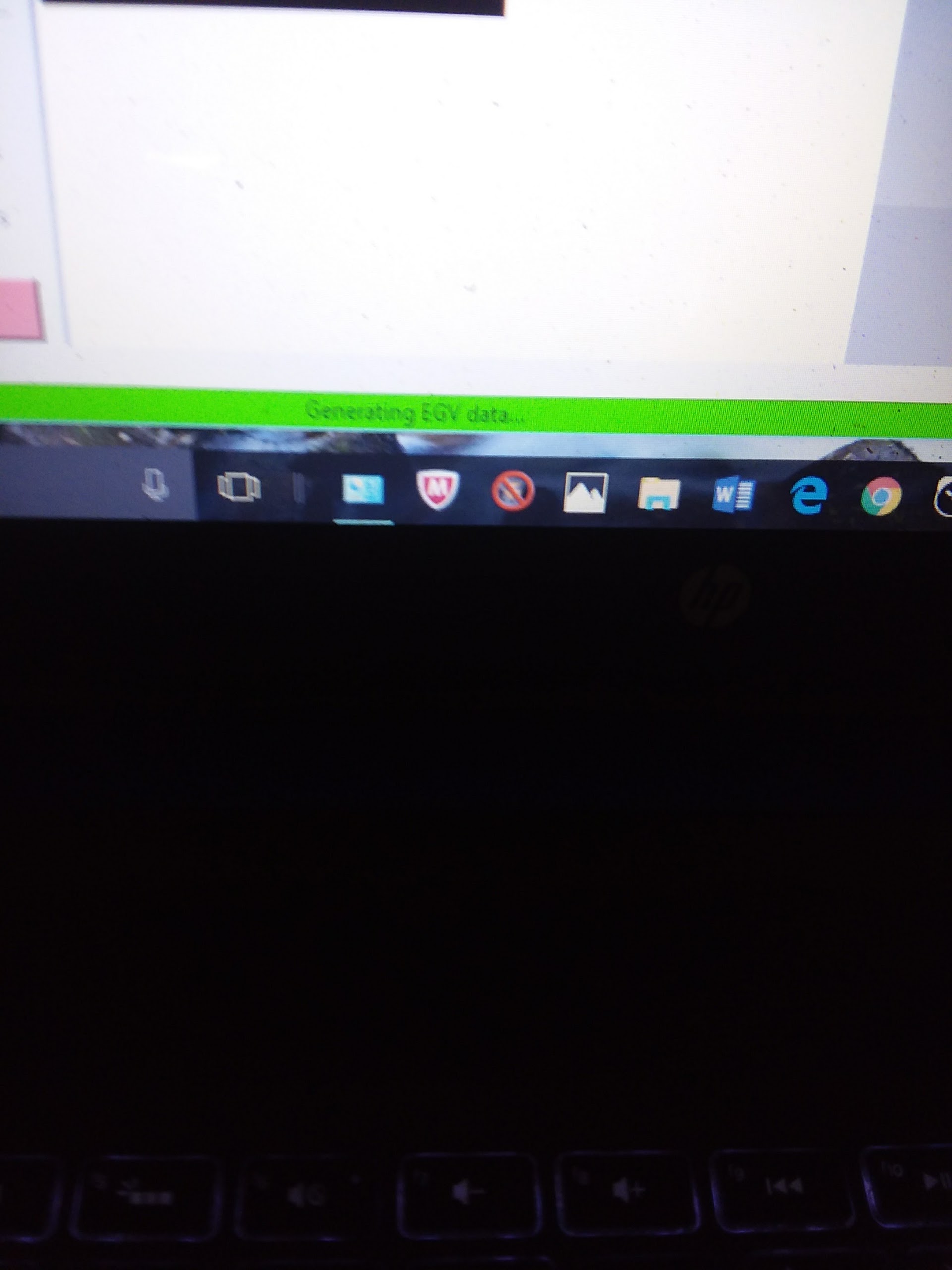

Hello, would anyone happen to know if there is any other software that runs the K40 Lasers ?? other than the Laser Drw or K40 Whisperer ?? I appreciate your time and information, new to all of this and really enjoy when I get this thing to work, but lately nothing but problems, hoping for a simpler solution :slight_smile: here’s the error message I am getting, very confusing
Looks more like a USB communication issue than a software issue. Try a new cable or even another computer if you have one available.
I was having comm problems for a time and ordered aTripp Lite USB 2.0 A/B Gold Device Cable with Ferrite Chokes, 3’ someone recommended here. That solved the problem.
It is an out of memory error. I fixed it so there is a better error in v0.06. The available memory is artificially low because I have only been releasing 32bit executables of K40 Whisperer. I have a 64 bit version ready but I think users may need to switch to a 64 bit driver. I need to do a little testing.

The fixed 64 bit executable is now available on the K40 Whisperer web page.
