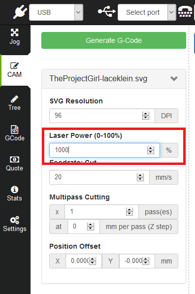

But I have to set Laser Power to 1000. Then it cut through normal paper. But I use cardboard it won’t cut it.
$30=1000 and this value is also set in the settings in LW
Can I go higher then 1000 to get more out of the laser? I’ll try some values during the day.
Thanks for any help.
Version: LW 30552(Git); Grbl 1.1f
