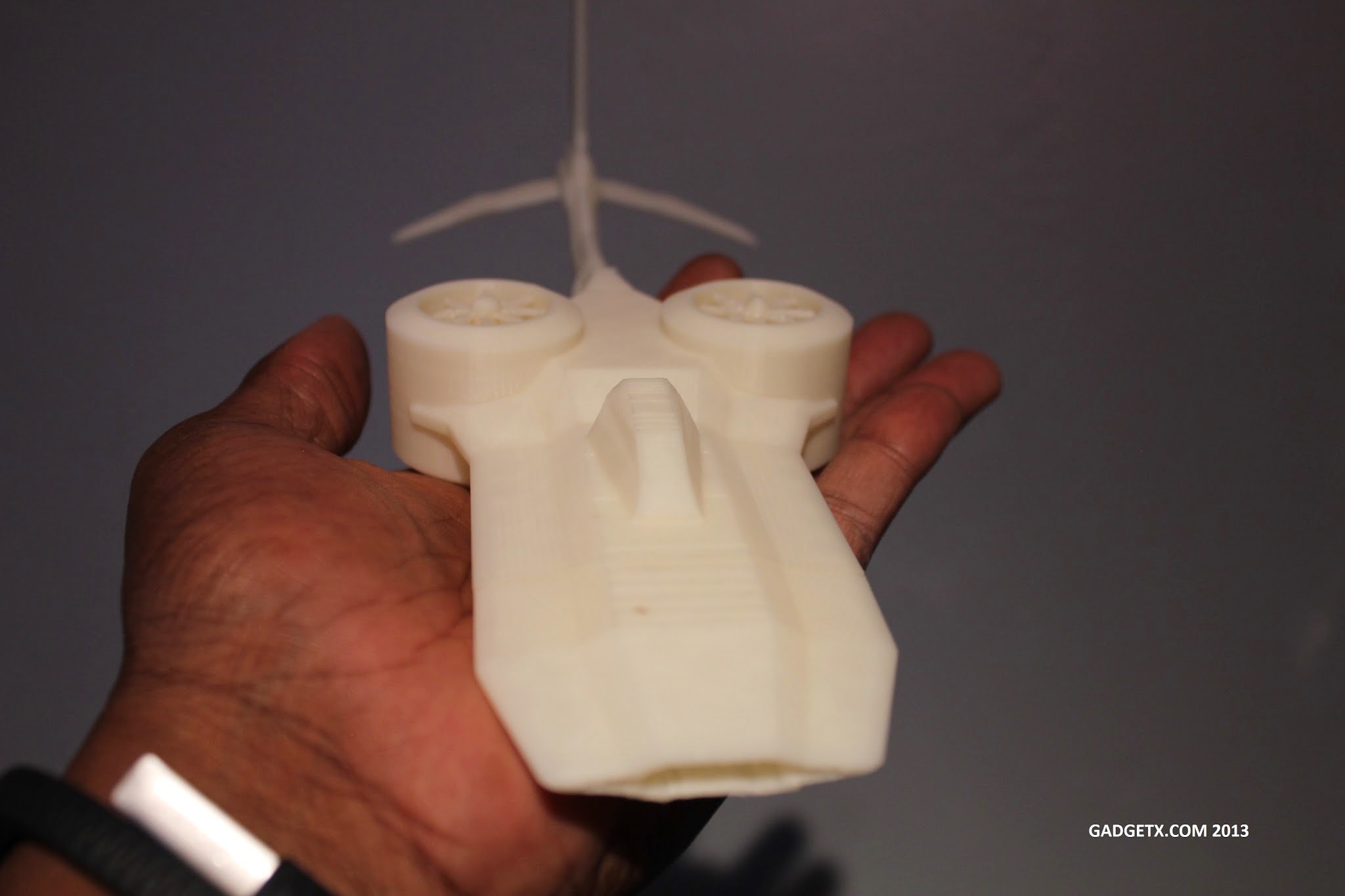

Helopter model, printed with ABS with the Makerbot Replicator 2X.
Helopter model, printed with ABS with the Makerbot Replicator 2X. I was really pushing it with the propellers, the blades are way too thin as support material was really difficult to remove without breaking them. I will probably have to change the design going from 7 blades down to 3. That would be the biggest change for this model from the 1994 original.
