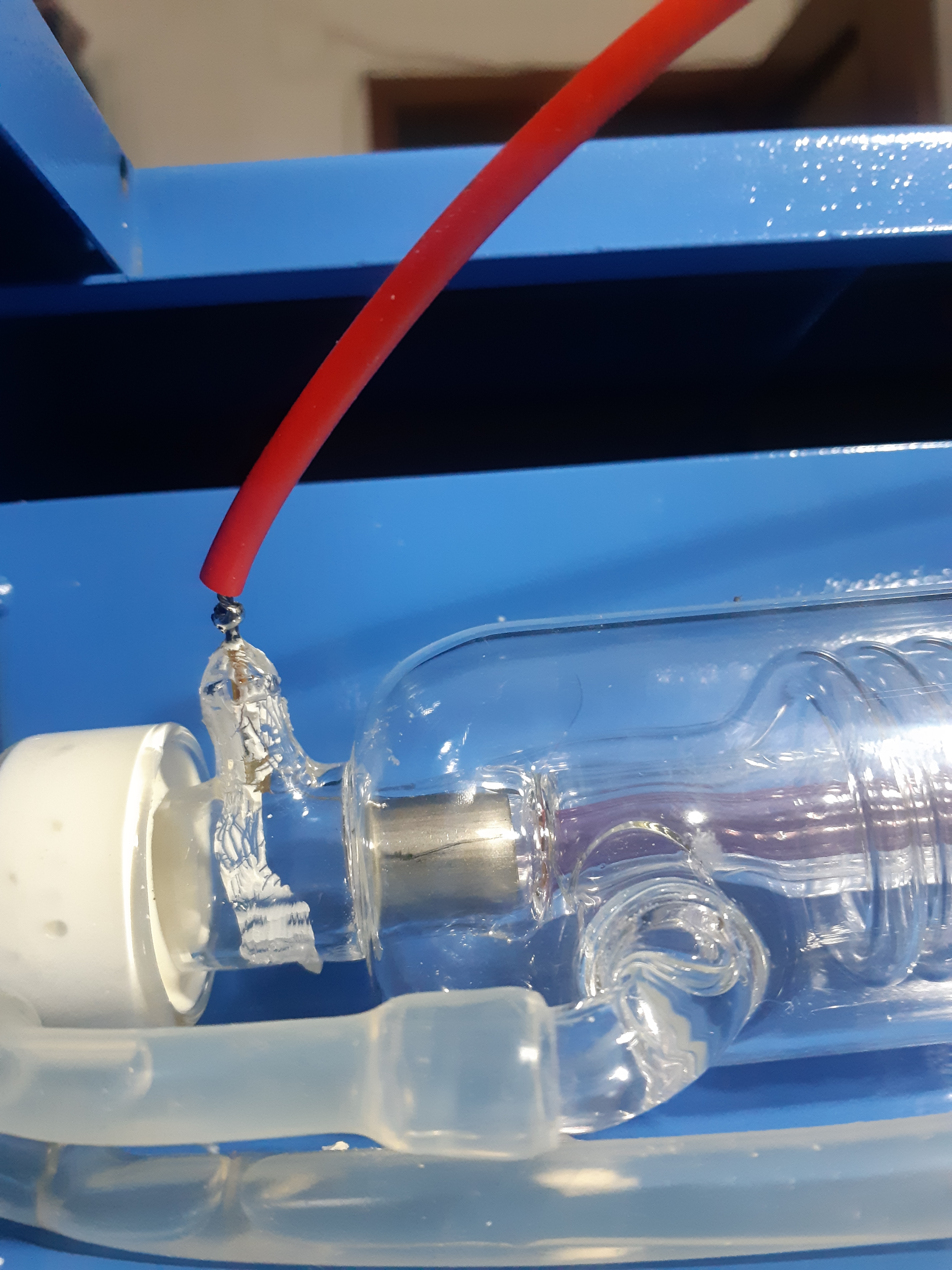

The situation is that I am refurbishing a K40 generic laser with safety switches, analog panel, lights, the usual stuff you should do when you buy one of these ( The laser was working when arrived). The LSPS was upgraded with a new RS507, 700V, 5A bridge rectifier according to the info found here
Everytime I try to fire it there is a spark precisely between the HV and the HV electrode, no current measurement detected on the analog meter. I have redone several times the joint but there is always a “bang”. I really refuse to believe that the PS has gone bad, LEDs are lit and voltage is detected between terminal ( motors move accordingly).

A close up view of your connection would also help.
What did you mod in the LPS?
The mod was just to swap the bridge rectifier for a RS507, 700V, 5A bridge rectifier.

The HV wire wraped around the Anode and soldered
Filled with hot glue and a silicone sleeve ( no air bubbles)
