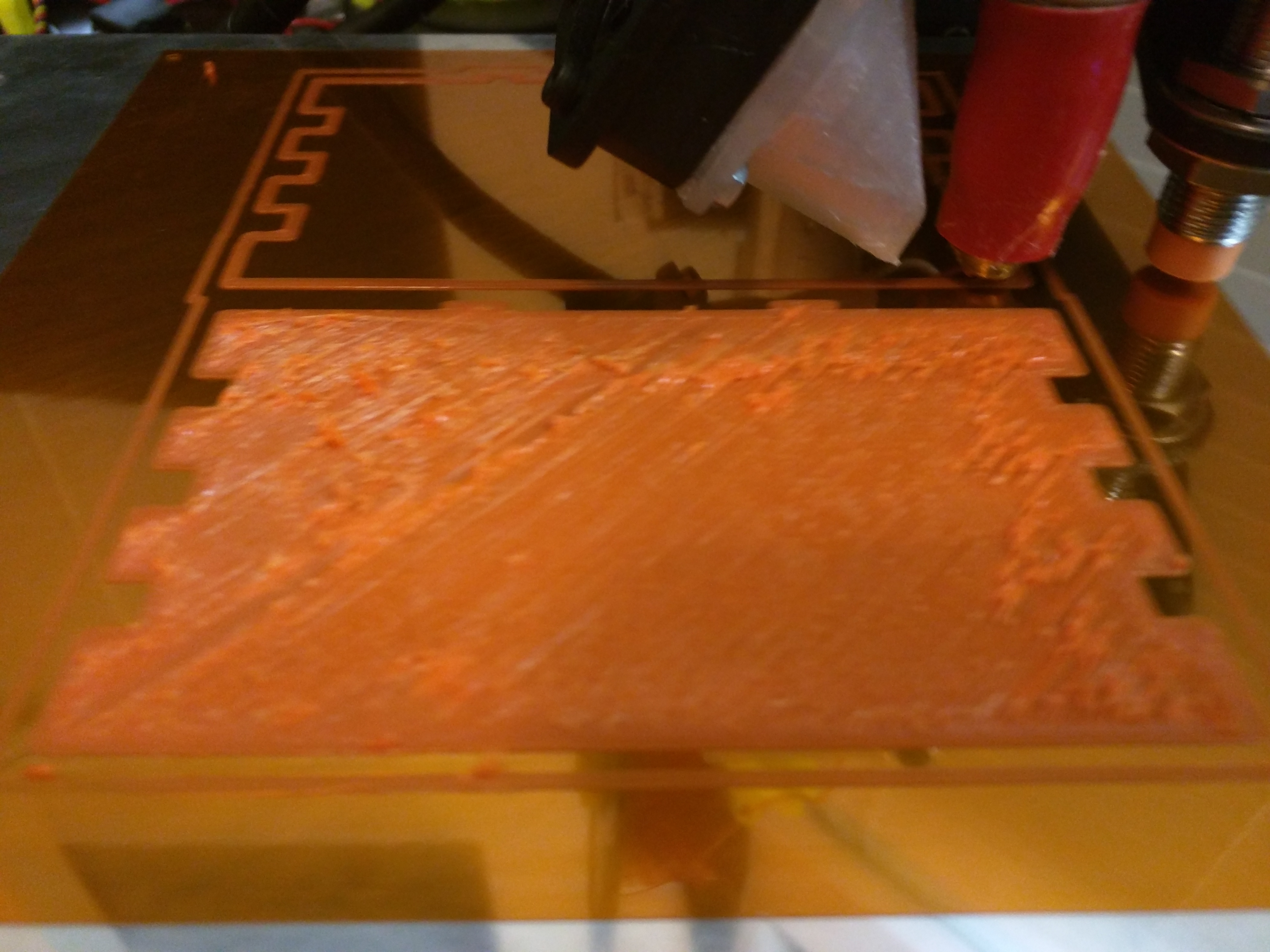

Help fellow 3d printerist. My printrbot simple metal was fine and now it starts outputting these strange over-extrusion for the bottom layer.
What could be the cause of this? I have measured my filament and it consistent with the value 1.75mm that I put into cura. My print speed is only 30 and the bottom layer is only printed at 20mm pee second.
I have the same problem, the rest of the print is fine. I turned down my temp from 200 to 190 and it seems to have gotten better.
I will give that a try. Thanks.
I had a similar problem, and found I had my z offset too low. It was restricting the flow out of the nozzle and clumping up. Try moving the z offset up about .10
If it’s only on the bottom layer, increase your probe offset.
It turns out to be a probe offset issue. Specifically the bolt holding the ubis hot end loosen and the hot end moves downward a few 1/10 of a mm. This makes the first layer single lines look flatten. And the restricted flow causes the issue. Thank you all :slight_smile: Everything is running smoothly now. One more thing to learn to diagnose.
Little loctite should prevent that happening again after recalibrating
@Jim_Wilson Might consider using the “light” loctite though (I think it is blue or HF#22) that is made to be forced off if necessary instead of the stuff that is basically all but permanent glue.
Lowering temperature may help.
loctite HGG. (hot glue gun)
