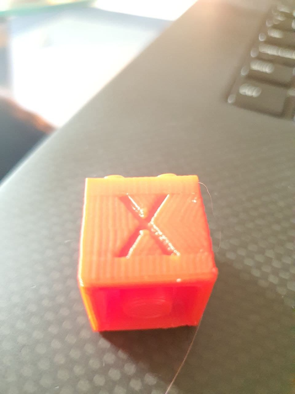

So, been working on my Eustathios, its technically a Eustathios 1 / 2 hybrid. For 5 years I have fought problem after problem until now where I have 1 problem remaining, extreme ghosting - See pics:
So it seems to be a lot worse on the X axis than the Y and for the life of me cant find the source of the problem.

Two things you could try that maybe would help. First thing is swap the X and Y motors with a powered off course. And see if you can get it to follow the motor or driver. Second thing would be lower the acceleration to something ridiculously low like 300 or 500 and see if it goes away. I haven’t run into those sort of problems myself in a long time and most of it was tied to alignment and bushing stick/slip especially when the bushings were brand new and tight. I know one person back in the Google+ days had a pulley that was slightly eccentric which was causing an issue. I think he switched to proper misumi pulleys instead of the cheap Chinese ones on the sides which helped.

@Ether_Bunny I’ve tried all different speeds, since last posting I have tried lowering the speeds along with higher and lower acceleration settings but the results are very much the same. If anything any deviation away from my current settings increase the problem which suggests it’s a hardware issue.
