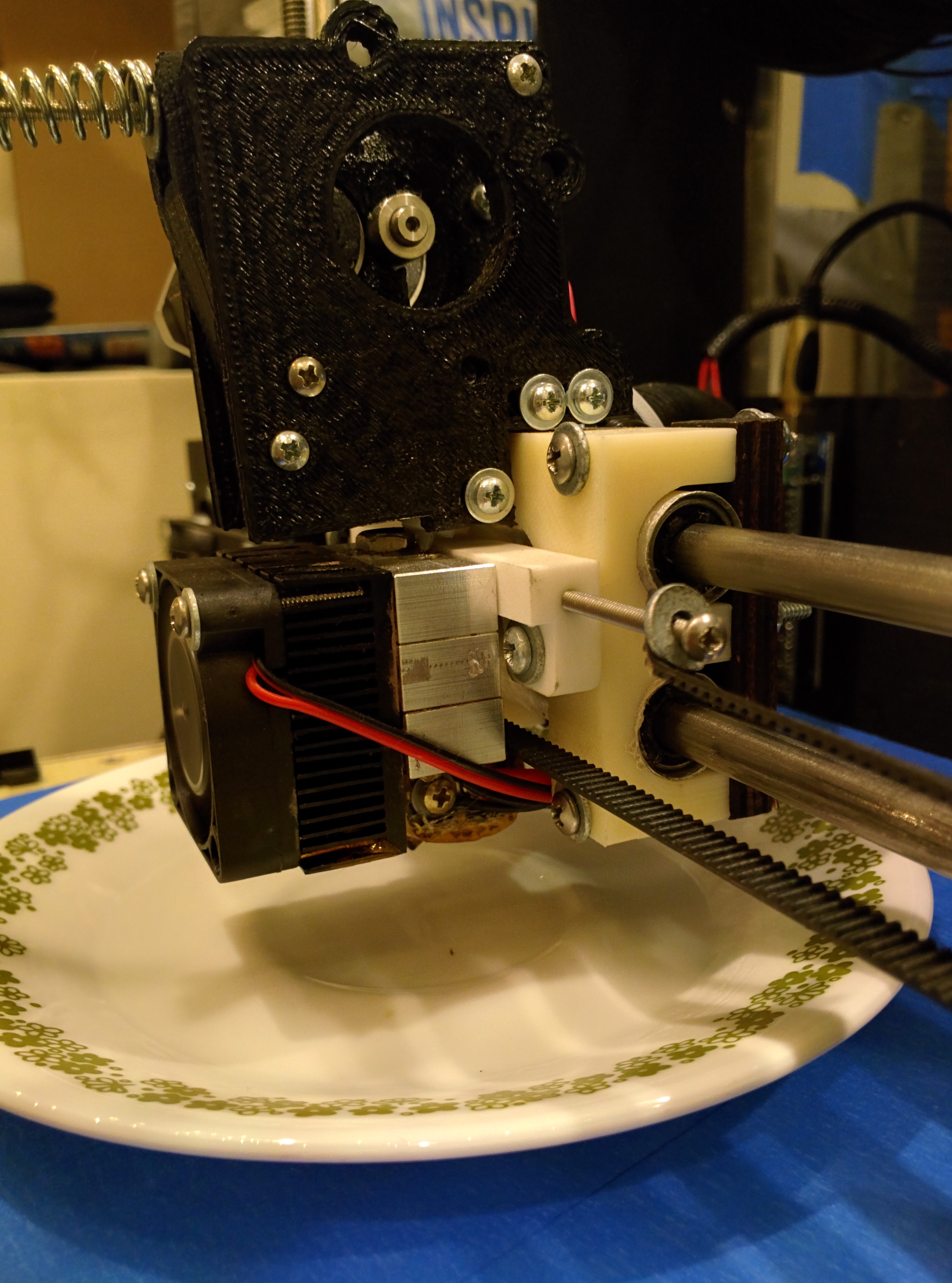

HELP! I have a homemade printer i bought a few years back and it
HELP!
I have a homemade printer i bought a few years back and it clogged when using woodPLA filament. I have used the filament before with success but this time not only did it clog, all my usual ways to fix it have failed. Any suggestions are appreciated.
