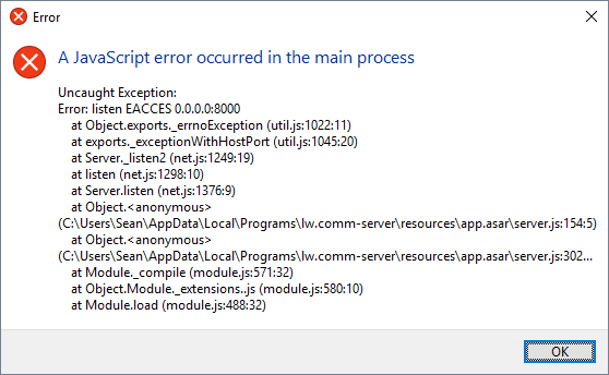

HELP… I love Laserweb. I have it running on my Win10 Laptop fine but when Installed it on my workstation I get an error " javascript error occurred in the main process" . Then I got a 404 error in a window. I have installed the latest Java. Can anyone advise.
Can I assume you tried a restart?
This error is usually tied with the port being occupied by another app.
There’s a way to change the default port it uses but I’ll need to look for it
@Ariel_Yahni_UniKpty I dont know if it has something to do with my Java installation. I have a stuck Java jre1.8.0_11full that I think was installed when I Installed Fusion. I cant seem to uninstall it. the MSI is missing. I have installed the lastest Java and it works fine.
@Sean_O_Brien_PapaSea don’t think is related to that. I’m almost sure is the port. But I could be wrong. ( Don’t think so )
Claudio can help resolve this
Java is not needed/used by LaserWeb4. The exe (Electron) includes a Chrome Browser with JavaScript.
There is no “.env” File by default, you have to create it (with a text editor). Just make sure the file is called “.env” (with nothing in front of the dot).
When you mentioned Chrome I thought it would be an extension doing this. Privacy Badger etc… I turned them all off and still no luck. I will check my laptops installation and see if the ENV file is there.
You don’t have to fiddle around with browsers and plugins. If you installed with the setup program, you get a exe which includes everything needed. The only requirement is, that the IP port 8000 is free and nothing is blocking access to it.
A .env file is usualy also not needed, but it can be created if you can’t use the default port for some reason.
@cprezzi So I did a lot of poking around with Netstat -abno and I saw that this program raysat_3dsmax2014_64server.exe had seized com port 8000. This is from an old install of 3DS Max 2014. So now I dont get an error anymore, but laserweb does crash as soon as I open the connection tab. Get the laserweb has stopped working. SO frustrated. But thanks for getting me this far.
