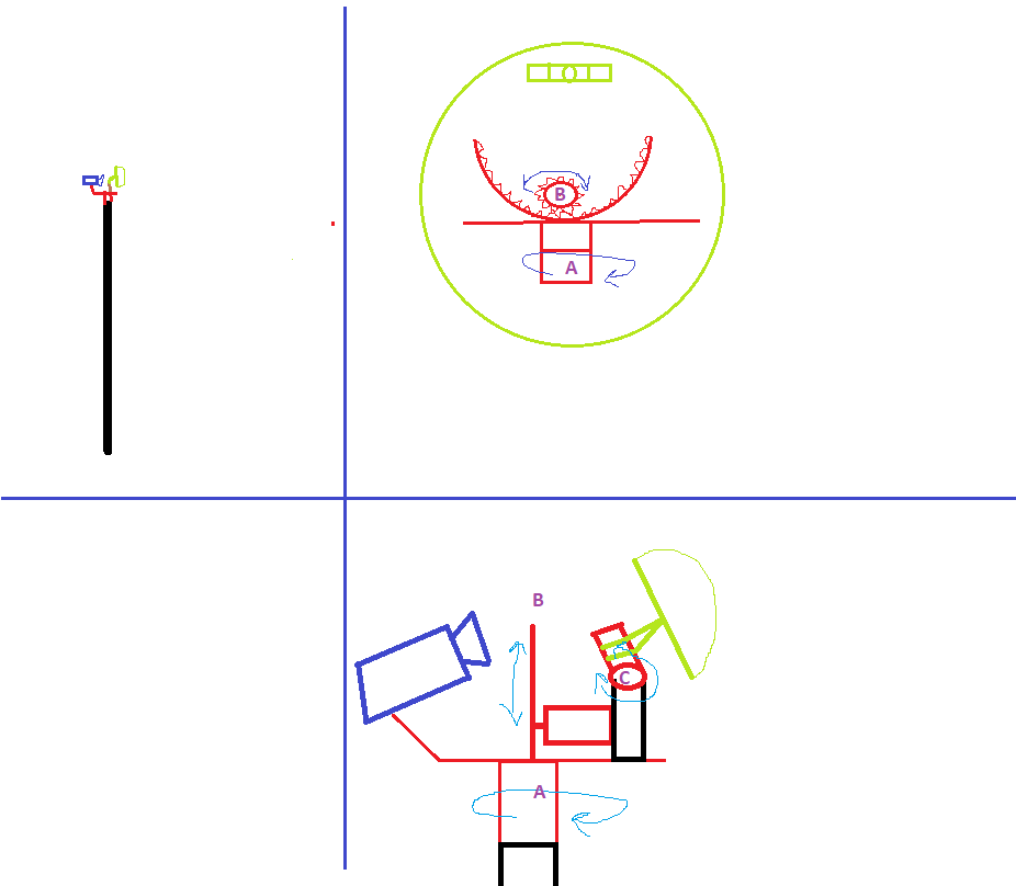

I have prepared a dirty sketch to give you a feeling of what I am looking for.
A,B,C are the labels of the motors/gears (in red) the antenna is in green the blue arrows show what I expect the movement of each motor to do
I also added a camera (blue box) that which basically doesnt need to be something fancy just a simple low res sensor I need it because the ubiquiti antenna has a level indicator on its back so the webcam would be pointed at that level indicator and feed the signal to me over lan so that I know the antenna is leveled the cheaper the better I only need to be able to see the bubble be in the middle of that level indicator on a sunny day.

Also could you help me a little about the topology and kind of motors/gears Ill need? I mean looking at my sketch I already found some flaws example B needs to be the other way around and attached with C :stuck_out_tongue:
Or maybe B (righ left tilt) and C (angle up down) could be just a double sided motor and I would need just to add some gears to change the ankle of the angle ?

A&C motion:
You can buy these kits or the parts for them.
Alternately they can also give you an idea of how to build a turret from discrete servos and mechanical parts.
B Motion:
The vertical translation is harder to get but something like this would accomplish the vertical (B) motion:
Why do you need the B (vertical motion) if the C motion exists???

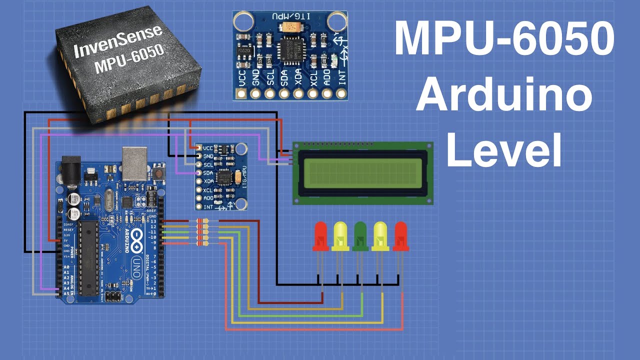

I wonder if an accelerometer would be a simpler approach to detect angle and level.
You may be able to get ideas here: Product Insights
