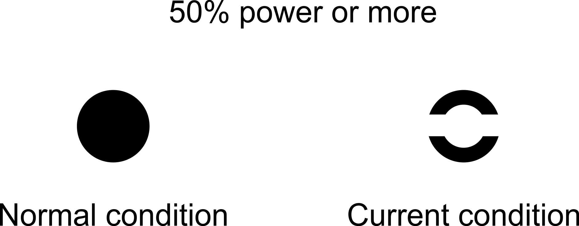

I place a clear plexiglass in front of the tube before the first mirror and press the test button. Even with 50% power, i can see there’s only small mark on the tube which is totally different with normal condition. Previously in normal condition i can see a full circle mark on the plexiglass, but now the beam mark on the plexiglass like only “O” shape letter. What i also notice is increasing power from 40% to 50% or even 80% looks like nothing different.

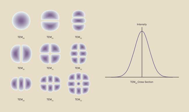

It looks like your laser is acting up and running in the TEM01 mode vs the normal which is TEM00.
There are many reasons why a laser “mode hops” such as changes in the resonant cavity, temp, including the supply.
Though from @Chris_Hurley experience, it would seem most likely some thing changed inside your tube, don’t know off the top of my head what else to suggest.

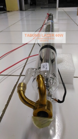

The tube is still arcing. I plan to replace with 60 watt tube. How significant is the power between 40 and 60 watt? what speed i can achieve to cut 3 mm plexiglass with 60watt tube assuming the optical is in a good condition?
@Alisha_kansha I would suggest the power between 40-60 to be significant assuming you get a good tube and LPS to match. I plan to do it some day.
Search this forum for others that have done it for advice. As a minimum you will have to extend your box and get a new LPS.
I don’t know a #, of the top of my head, how much faster you will be able to go as there are lots of factors relating to your actual machine. “Lots faster” I would guess :).

I plan to buy this one
and tube from local company which i believe it is a chinese tube also.
