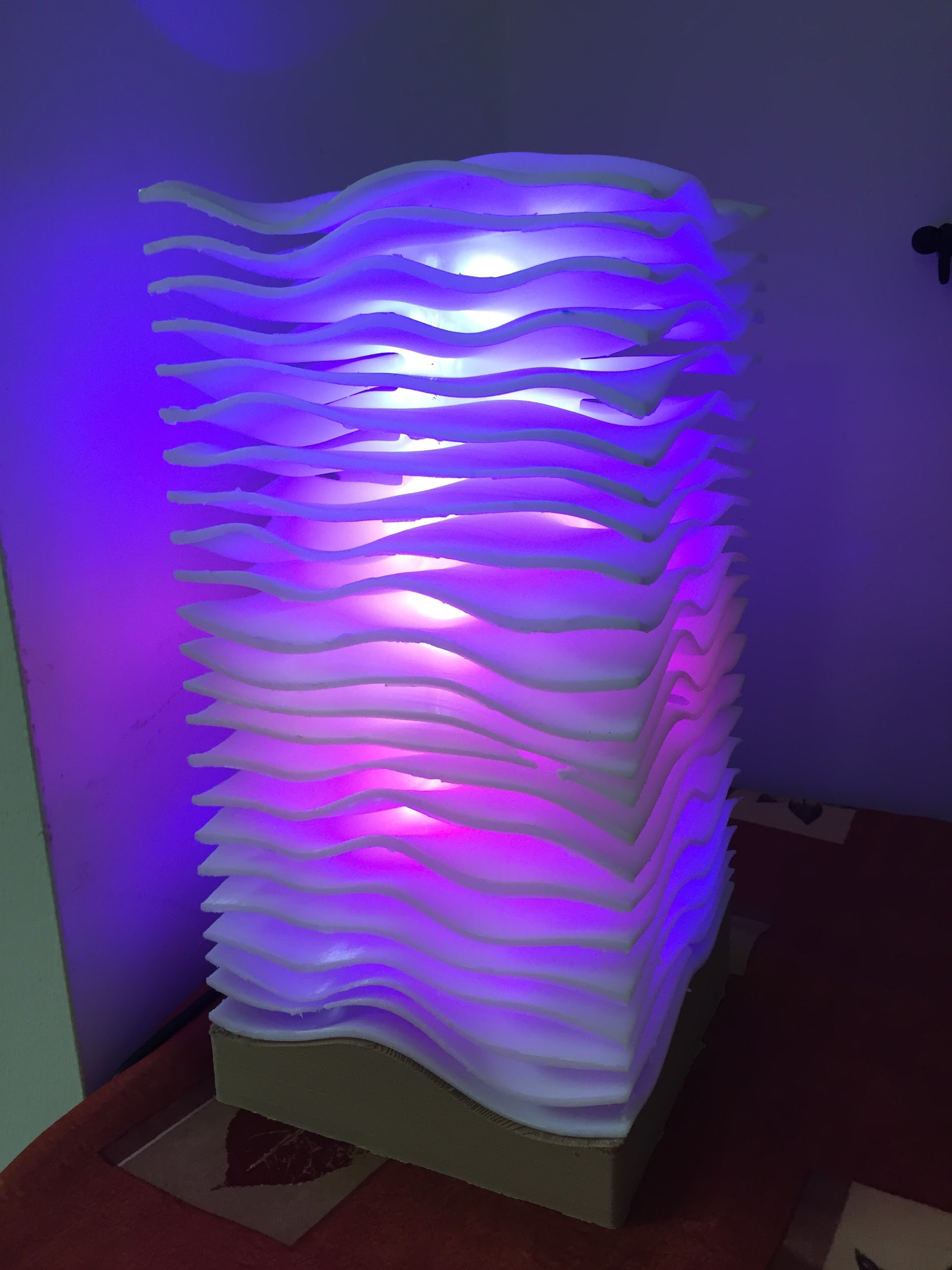

How are the wave shapes made?

@Erik_Rosengren The waves are 3D printed.
