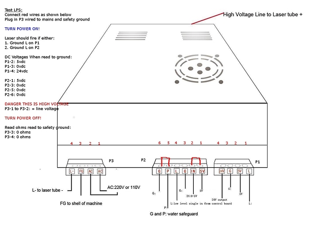

I’ve downloaded a schematic, and I’m competent with a VOM and I know enough to stay away from 15K volts. I would assume there’s a capacitor in there, too.

Lets test the “IN” function;
Set the “Current Regulation” pot to max.
With the DVM set on DC volts measure the voltage on the IN pin relative to ground. With the pot at max is should read 5V.

“IN” voltage = 5v
5V terminal to ground with amp meter full rotation = 5V
However, the 24 V terminal on P1 initially reads around 11V and rapidly decays to 1V. As I read the schematic, this should be constant 24V. This, I would guess, is were the problem resides.
Does that seem reasonable to you?
Also,jumpering across the terminals as shown does nothing.
Mike
I always remind everyone that there is no foolproof way to test this LPS and the problem can be the LPS and tube.
However, the HVT [high voltage transformer] is typically what goes and that is where the 24V is also developed from. Sounds like a bad supply.

Don… your analysis was correct. It was the LPS; when I pulled the old one, there was considerable discoloration around the transformer. I just finished installing the new one and it test fired fine.
