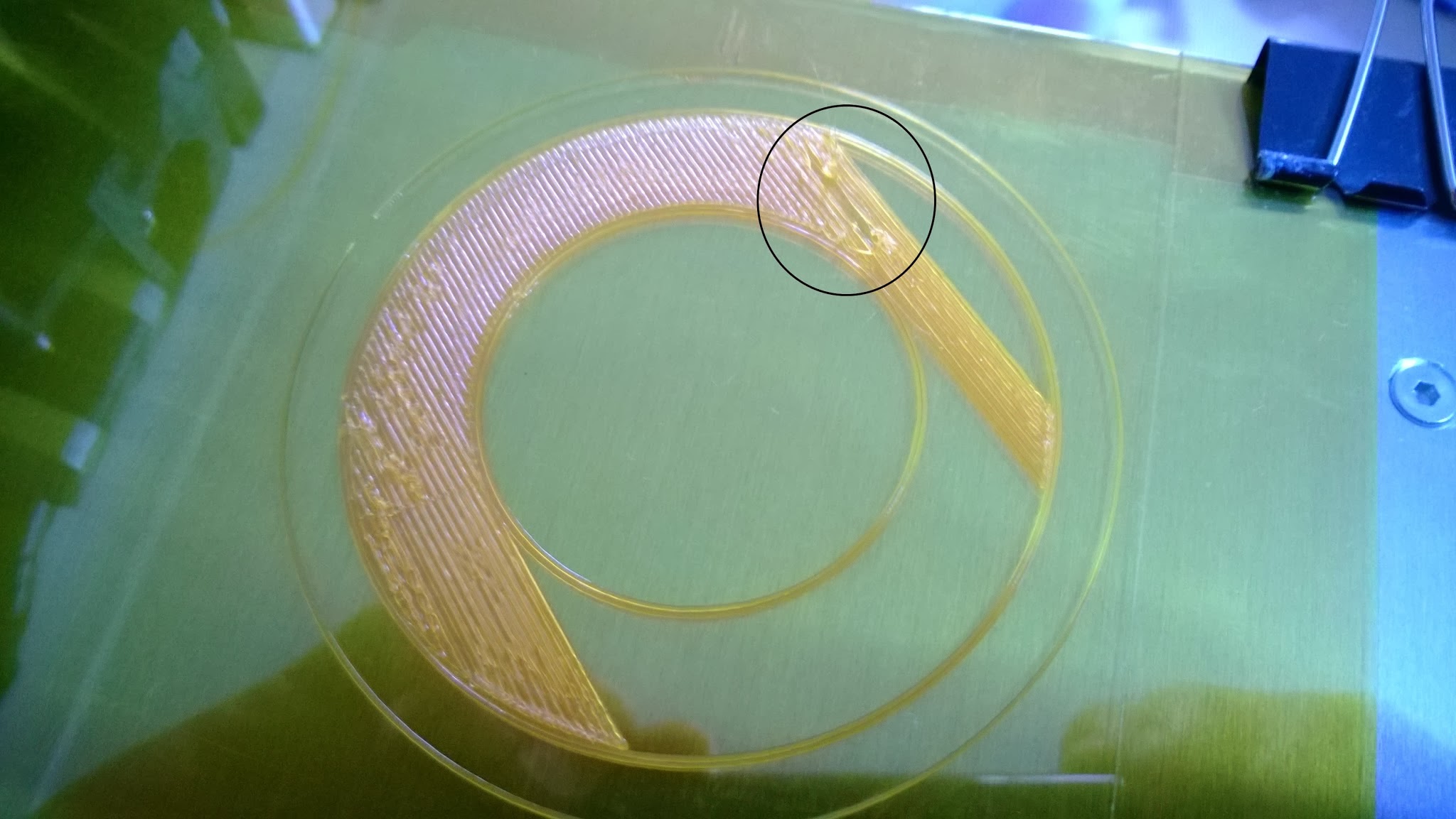

After months of successful printing I’m now running into various extruder related issues. It seems that I’m having a couple of problems. For PLA, it all seems to extrude OK but the PLA just falls off the bed (see the circle in the photo). The photo is pretty good, normally it all comes off and ends up a great mess.

Does the photo above look like it is too hot or too cool?
If it comes out curly then that is typically a sign of a partial plug. maybe there was some debris in the filament that wasn’t visible causing this.
